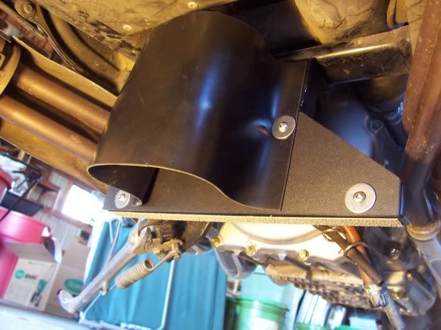

Finally got the adapter and stebel air horn mounted like I wanted. Took some pics during the install and thought I'd share them in case someone was interested.
Cut up an old plastic mudflap and some left over neoprene rubber from the saddlebag install and put it all together to protect the horn and adapter from any stones, mud, etc.
And yes it is still LOUD !!!

That'a a great idea on stebel mounting.  Where did the adaptor come from?  Is it one of the eBay models?  Love these ideas from the board.
Here it is .... click HERE

Mike, do you know if the spoonland adaptor will work with Big BF's quad horns?
The Spoonland D00d doesn't make them anymore (or didn't when I looked a little over three
years ago).
I got a Spoonland "type" adapter, the red one from eBay, and it works great with a quad horn.

I don't think the "Spoonland" adapter or anything similar is meant to be put on the bike permanently.  Some people on this forum will attest to that as they (adapter) have fallen off and nearly killed the rider. If you want a permanent one go with the one I mentioned.
