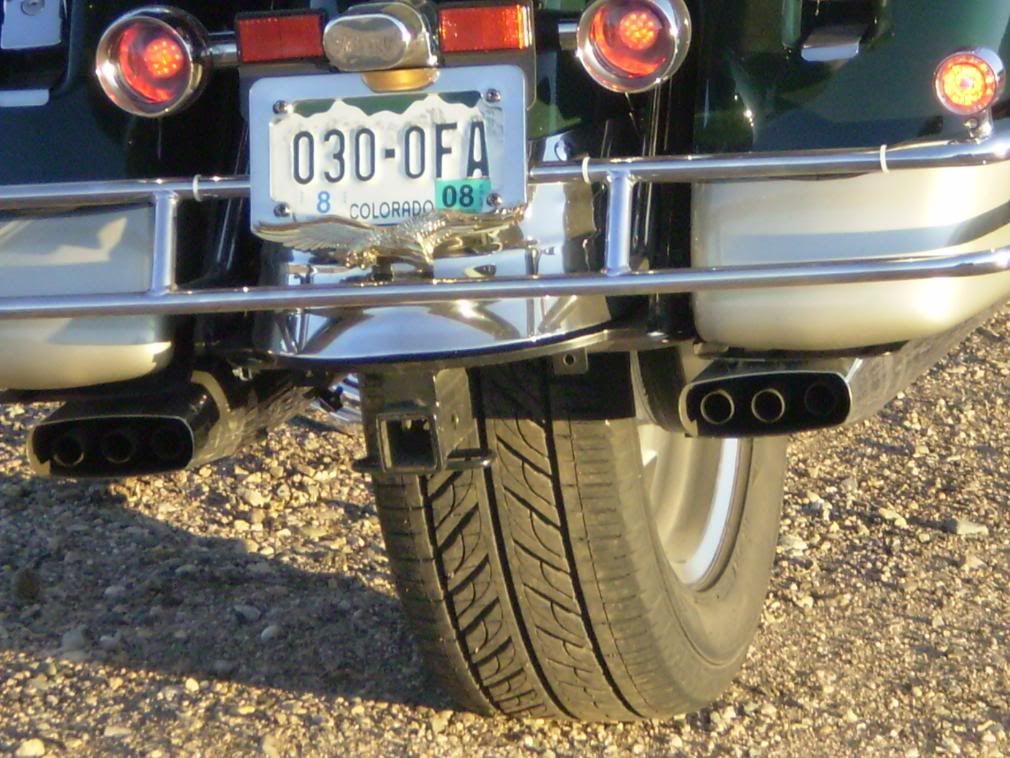

« Reply #11 on: April 27, 2010, 06:35:09 PM »
http://i232.photobucket.com/albums/ee201/6packvalk/PoudreCanyonRide4-08016.jpg
I run a brigestone. Only one CT I have ever ran but I really like it. No complaints. Next time i will use the goodyear triple tread because I like the tread design.
