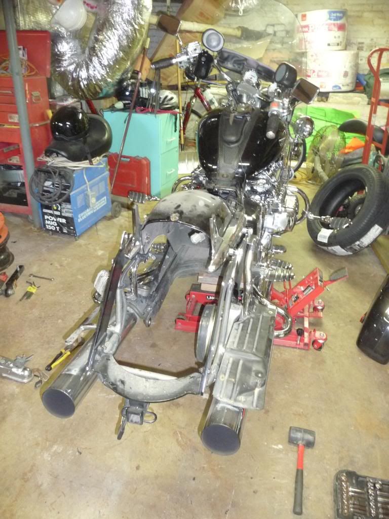

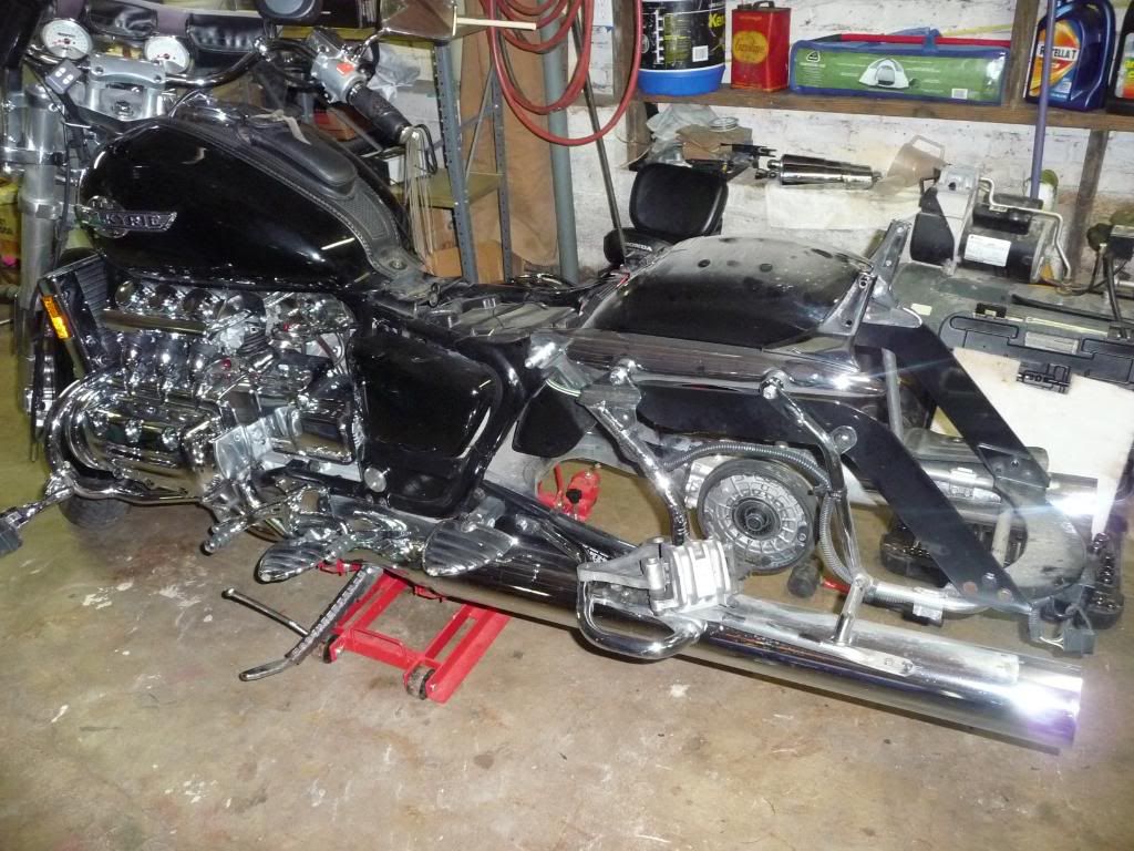

Only got about 3,000 miles more out of the rear avon after replacing the final drive setup and everything that went along with that process. Pulled th rear section of the rear fender as well since I decided to try a Goodyear Triple Tread to decide for MYSELF about this dark/light controversy. Not asking for any input on that decision. Doing the nutcage mod while in there and was wondering how I know if I need to add washers as it seems I read some had to do that? If I need to do that, does anyone have pics of what/how to do what's needed? Thanks in advance for any mechanical input.

Didn't remove pipes either.  Wink Removed rear fender to do nutcage mod while it was apart so I wouldn't need to rip her down again for rubbing. Definately looks like I need the washers as it's off center looking after just setting the wheel back up against the drive. Sure hoipe a few washers is all that's needed. Also hoping the hitch doesn't mess with doing the Goodyear. Here's some pics. I'll check back on opinions when I can. I'm in the process of changing ISP's and have to steal a signal ffrom wifi spots when I get time til Monday. Thanks, Dave

Three nice pictures of your tire for sure!
Can't use that for determining what's going on but,,, looking at the pattern inside the fender it would seem to me you are running dead center inside the fender.
So if anything is off, it may be related to other things and not connected to the swingarm and frame alignment.
Yeah, realized after posting the pics don't really help much. I just had the wheel set onto the final and upon reevaluating it I think after everything is actually secured in it's place it should be fine with just the nutcage mod being done. Getting anxious to try her out as trhe weather has been beautiful. Thanks all. Dave
