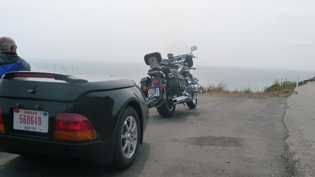

I have a hitch doc and went 7k miles last summer with it and trailer and am very happy with it. I can remove the ball and you can hardly tell I have a hitch.
