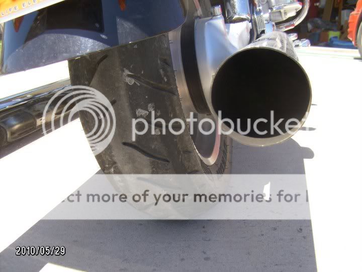

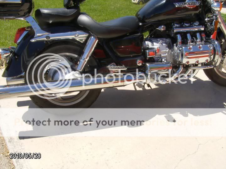

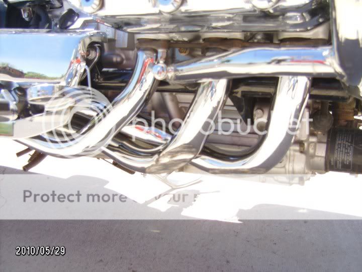

Here are the links to the photobucket images:
side view:  http://i817.photobucket.com/albums/zz91/elraque/valk_exhaust_pic.jpg
Smushed header: http://i817.photobucket.com/albums/zz91/elraque/Valk_Smushed_pic.jpg
Rear view -- No baffles in here!
http://i817.photobucket.com/albums/zz91/elraque/valk_tailpipe_pic.jpg

Look like stock headers. Have a look underneath the exhaust, is the chrome section larger than the pipe going into the muffler? If so it is standard. Have look into the end of the system, is there 1 or three outlet pipes. 3 would most likely mean it is stock. Single either stock and been cut off or has had the glass pack mod.

This is the stock pipes.......
Yours has had truck stacks put on them.  These are truck stacks......
http://store.airflo.com/af40-438hs.html
This is how to put them on a set of stock pipes.......
http://www.timskelton.com/valkyrie/how_to/stacks.htm
The other possiblity is that your pipes have had glasspacks installed on them.  Basically, the pipes have been butchered and have had glasspacks welded on with the truck stacks put on over the glasspack.
This is a glass pack mod......
http://www.valkyrieriders.com/shoptalk/noteasy.htm
Either way.....stock pipes with truck stacks, or glasspack mods with truck stacks, you're gonna spend some buck$ to fix that crunch.
