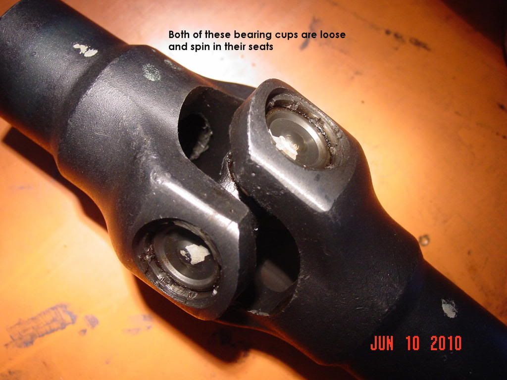

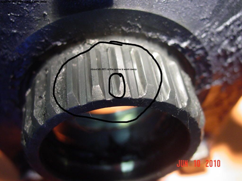

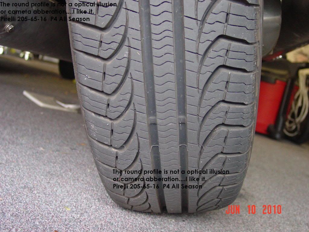

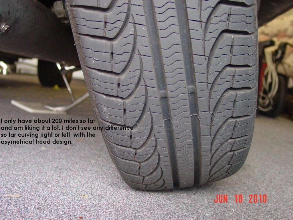

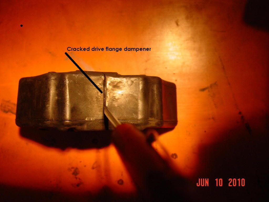

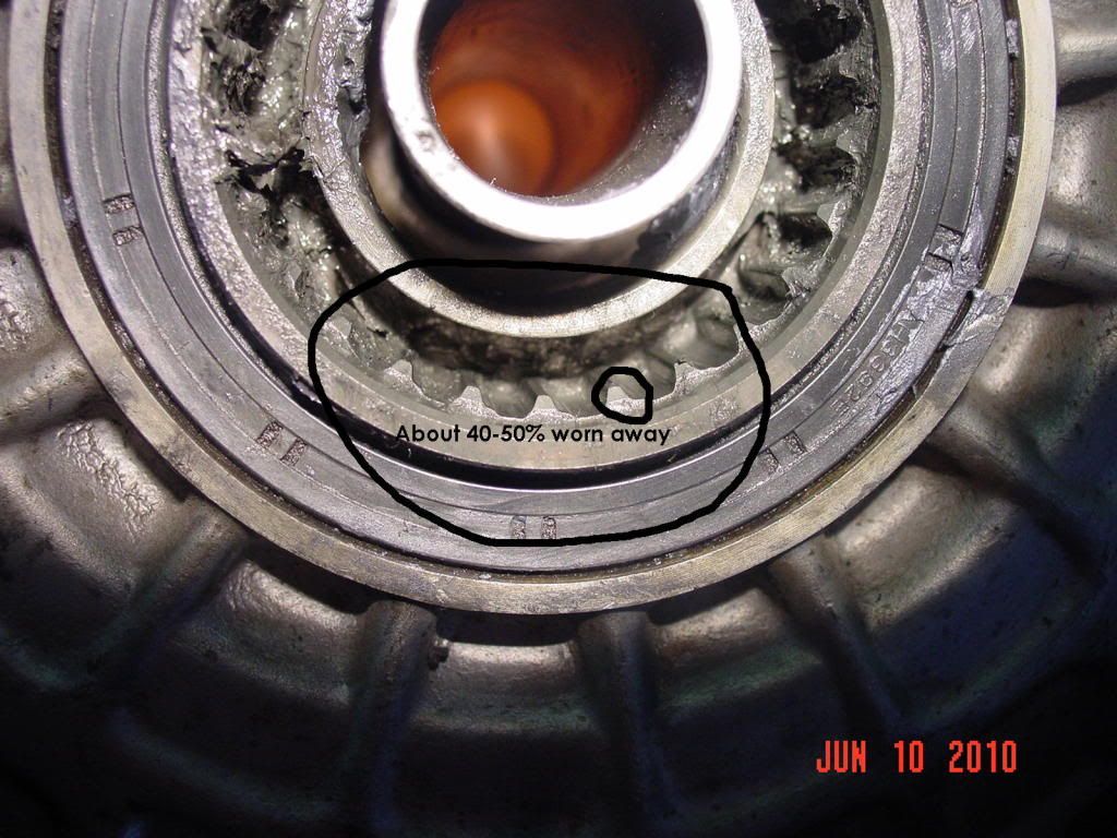

WHOOOOOOEEEEE, its almost like a new bike.  Just finished up replacing the ujoint, drive shaft, final drive, driven flange and rubber dampeners, new rear car tire (went with the Pirelli P4), made a 100 mile coffee run and can't believe how quiet the rear end is.  Will get the new rear tire front mounted tomorrow, went with a Bridgestone 150-70-17 (TW152) and will mount it per the rotation arrow.  I will post a pic of the final drive splines...you won't believe how worn they are, drive train lash reduced about 90%....sure feels nice.

Curious to see how much wear you put on it

So here is your STUPID picture!!!!!!!! tickedoff 2funny crazy2 coolsmiley uglystupid2 police angel laugh Evil :'( Kiss Undecided Embarrassed Lips Sealed

OK..OK....here is s'more.

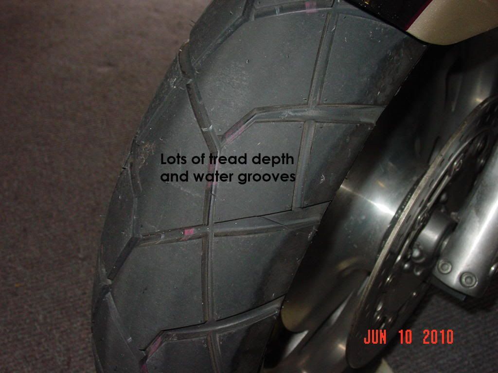

The front tire is a Bridgestone 150-70-17.  My speedo is now off by 6-7 mph at 60.
Sixty indicated and 53-54 showing on the roadside radar.
The front (rear) tire is mounted in the direction of the rotational arrow.

Those splines actually aren't as bad as you think, but I'm sure it's peace of mind getting all that done.  cooldude
eric in md
Posts: 2495
« Reply #5 on: June 11, 2010, 05:55:53 AM »
how many miles on them splines?
Rio Wil
Posts: 1368
« Reply #6 on: June 11, 2010, 07:55:15 AM »
The splines have 112K on them total, but they have been worn for some 40K.  So, even heavily worn splines will last a great number of miles if they are kept lubed and the axle/final drive bolt tightening sequence is observed.
Rio Wil
Posts: 1368
« Reply #7 on: June 11, 2010, 08:05:47 AM »
Half the spline width is gone on both the male and female spline,  they can last the lifetime of the bike with virtually no wear if properly lubed and the assembly procedure is followed. I don't know how much further these could have gone  before a little exuberant acceleration might strip them off!  Better replaced than stranded.
Hence my statement about it giving you peace of mind.  Roll Eyes

The splines in my rear drive are about  the same as you show your to be.
Still, I lubed them up and took off for the ROT in Austin last week.
Total drive was 2500 miles and no problem although it was worrisome at the outset.
Looking to inspect them again soon, but what a pain in the ass to do!
Ordered the main parts before I left, just a few more item to get before starting the overhaul.
