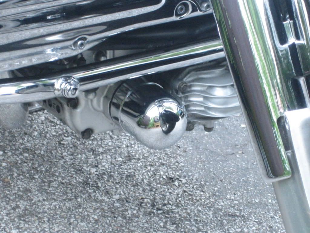

My first time changing the oil on this bike.  It has a RIVCO chrome cover on it.  I removed the set screw and can't get the cover to come off (easily).
Does anyone have a nice easy method?  I'm sure I can get it removed, but that may also lead to having to get a replacement.
Any help appreciated.

When ya get all the screws loose or out, tap it on the side towards the bottom of the filter and then tap it on the other side.   Repeat as long as needed.
has and Chrome have a tendency to swell.   Then it corrodes real easy on the inside, sothe hole got smaller and tighter..

Here is what I would try:  I assume you want to remove the filter (or I would wait until I wanted to remove the filter).  I would put a strap wrench around the Rivco cover and turn in the direction to remove the filter.  If the filter turned, I would remove both as a single unit.  (Of course if the cover turned independent of the filter, your problem is probably solved).
I assume the raised lip of the oil filter sticks out beyond the end of the filter cover.  I would wrap the cover in a cloth and put the cover in a vice.  Then I would gently tap around the edge of the filter with a hammer and small chisel (read screwdriver for me) and try to get a little movement.

I had to remove one of those a few years ago too. I drilled a very small hole in the end of it to let air in while the cover was tapped off. After the filter change, I used a light oil to stop rust from causing this again.

Thanks again.  There was some light damage to the cover but it is off.  The filter was destroyed in the process (with great prejudice I must add).  I feel pretty good because most all the advice I tried at one point or another.  It wasn't rusted at all, but there might have been a small dent in the cover.  I have decided I will put it on again and if it doesn't come off easily next time I might work it out ONE more time.  But then it will have to find it's way onto ebay.

 Hey Henry , I agree with Vanagon but what I did alittle different on my Rivco cover was after I drilled a very small hole in the center of the face of the cover , and I used compressed air and it pushed it out little by little while holding it in the vice by the filter lip at the same time pulling and twisting the old filter out ...... and don't over tigten the vice to tight because you might warp the filter alittle  ....  I found out in the begining I found that an OEM Honda filter slipped right in the first time being dry , and I could hear the air being pushed out at the same time causing a vacum so to speak ... I also tried the ol vice and rag trick but no go ...  after finally getting the old filter out , I slicked the new filter down with some anti-seize medicine and it works for me ..... to get the used filter out , you'll wanna twist it while your pulling out the filter and I like using a strap wrench , makes it easier  cooldude
