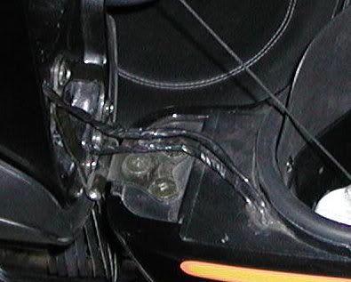

Here's some old PICs of how I ran the spoiler (and speaker) wires
