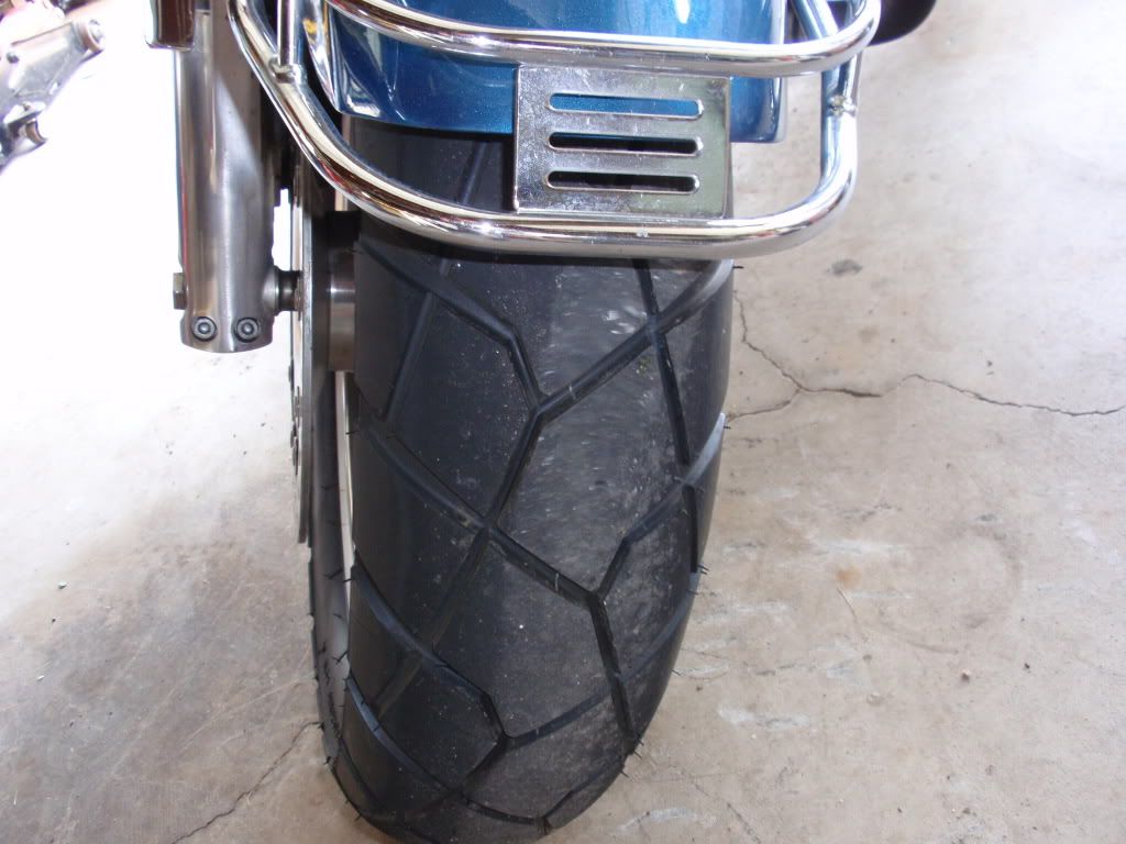

« Reply #5 on: August 12, 2011, 09:07:35 AM »
Just purchased the Trail Wing rear tire for the front tire replacement for the Dunlop Elite front. I took it out for a ride and was surprised at the way it handled. At first I regretted having bought the tire as a front tire, but that quickly changed after I realized that my inflator/gage was off by 5 lbs on the high side. I felt the bike diving into slow turns (5-10 mph), kinda like the front was out turning the rear. I used three other tire gages to confirm my suspicion. After adding the 5 lbs of air to it it was much better. No more diving at all, just a tad quicker. This may be due to the fact that it is 150-70 as opposed to a 150-80 or that it is new, or that the pressure needs adjusted.  This tire feels like it rolls as you turn as opposed to carving as you turn. It is smooth and as of now i am glad that I purchased it "so far" after using it for apx. 125 miles. I could see how it would like to dive after putting 25,000 miles on it. I could not believe how good it handles. I was not a believer but had to try it for myself. I HAVE NOT tried it on all surfaces nor have I had a chance to use it on wet roads. I AM NOT RECOMMENDING  this tire for anyone else. Just saying that so far" I "like it. Also keep in mind that I am still using the Dunlop Elite rear with 50% tread on it. Who knows The P4  or a similar CT may be next If this one works out to be good. I figure worst case, I will change the Trail Wing out at 12,000 miles or so if I don't like it for some reason and will be ahead by a few thousand miles over a stock front tire. If you try it don't under inflate it. I am running 39 lbs at this time and will try it at a few more lbs. and also at a few less lbs. to see the difference. Once again I am not recommending this tire or any other tire to anyone. The same people who design motorcycle tires are the same ones that work for the companies that "sell" them to us. I am positive that motorcycle tires should not be wearing out as quickly as they do. Someone, please design a motorcycle tire that lasts at least 18,000 miles. I would be willing to pay a little more to avoid the hassle of paying for or doing tire changes as often as now needed. Maybe it would eliminate the temptation to push a tire beyond it's limitations.  Just my opinion> cooldude

Breeze
Posts: 123
USA
« Reply #10 on: August 22, 2011, 05:50:42 AM »
Here is a pic of it on my bike
