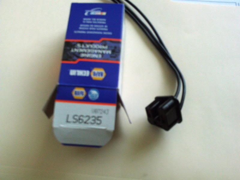

« Reply #5 on: June 24, 2010, 01:39:26 PM »
Heree's the High Temp, high current socket available at NAPA
