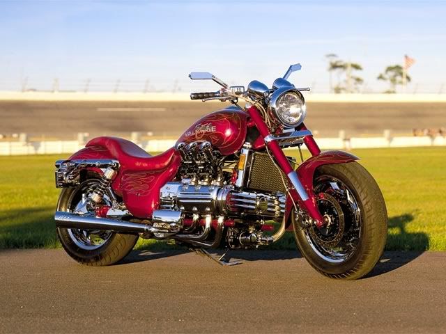

http://www.ufocycles.com/UFO_Page.php?title=UFO Valkyrie&type=gallery
I have seen another setup with a custom ram airbox scoop to deal with the legimate points ¿spoom makes.

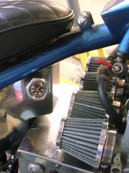

« Reply #4 on: July 13, 2010, 07:26:03 PM »
Here's another, Use to be in northwest IN, but haven't seen it in a while.
Those velocity stack bikes look awesome, but I can't believe they run too well at high speeds. Anyone got any info other than my guesses?  Wink Not badmouthing anyone, I'd really like to know how they run. Those are fairly deep stacks, which helps-I've just never seen setups like that work well even at 50mph.

That red bike looks like one that was in a Cruiser Magazine article. The article was "Custom Valkyries 6-cylinder Showdown"
You maybe able to find it online. Have seen another orange and black one, think it was in the photo galleries.
