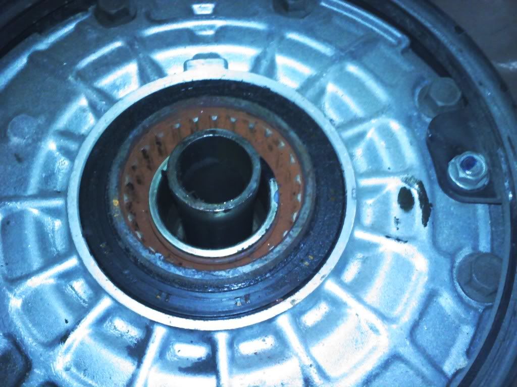

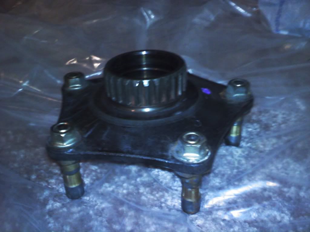

So is this what a pumpkin looks like? You think after three previous tire changes and 49k miles should it look like this?
Cleaned it up a bit.
little more cleaning should do it.
How do I clean this?
This has been a learning experience.

It is hard to take sharp pictures of that stuff, this is the one I can see most clearly:
It seems like the splines on your flange are still sharp and unworn? If so, you're probably good-to-go,
but like valkflyer sez, you don't want to be seeing that dry rusty condition in there next time
you pull it apart (in 10,000 miles or less)... I'm sure you know how to search up all the threads
where Daniel and everyone goes on about what lube, the three Orings, and the re-assembly
sequence...
MP

No, that is not the pumpkin.  The pumpkin in the final drive unit, ie rear end on a car.  That is the final drive flange.  VERY rusty, be sure to lube right this time, as I know you will.

Hey Raverez, it looks like the drive flange is the best of the two mating splines but like others have stated, it is hard to see in your pictures.
Mine is just like yours and I'm not worrying too much yet.
just clean the surfaces up real good, use a brush and plenty of kerosene  and the splines will come clean.
You can replace the 'O'-rings and lube the splines generously and there will be no problem.
I rode mine last June on a 2500 mile roundie and still no problem. I'm going to take a look soon and see if there is any progression of the wear. Right now I would say there is 50% wear to the flange in the pumpkin, but less on the drive flange, on my bike.

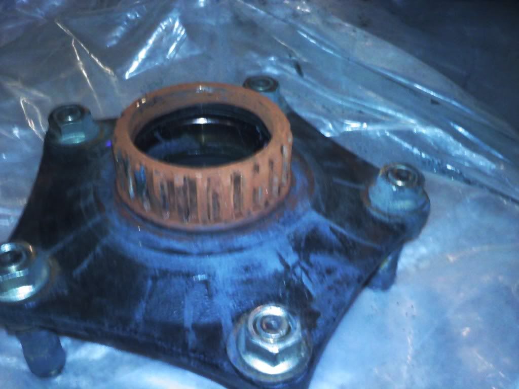

Both parts still look good and not worn out. I used a soft brass bush to clean the spline, but it won't fit into the other part. Took pics with my cell phone. If i spray it with PB Blaster or WD 40 would it damage anything?
Posts: 16815
« Reply #6 on: July 28, 2010, 10:53:45 AM »
I've made these little rat-tails out of bounty, and worked them in and out of there with the little flathead and gotten the splines
real clean. I looked at an awful final drive with gnarly hard caked on cr*p all pasted down in the splines, I wasn't afraid to scrape the gunk off with the
blade of the little flathead, which fit down in all the grooves. It was tedious, but it cleaned it up pretty well.
I don't think wd40 would hurt anything, and would help carry away the dried on stuff after you find a way
to scrape it loose...
-Mike "I'm only qualified to give shade tree advice..."

You could also try using pistol or rifle bore brushes.  Afterward make sure you use brake cleaner or a parts washer to flush the final drive splines.

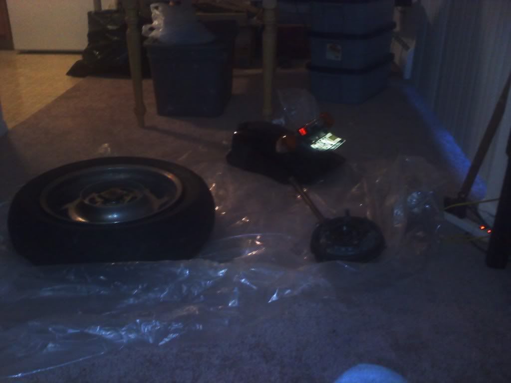

Well started cleaning the splines with small eyeglass screwdriver. found a hemostat, used the file part of a nail clipper. finally while looking everywhere, i ran across my gun cleaning kit. Used the round brush. cleaned up pretty good. Used bel ray on the splines, and drive shaft(hope that was the right thing) since I inadvertently removed it. Also put some around the wheel bearings and axle. Probably missed something, couldn't get to the computer and didn't have one in my "garage".
 The first floor(parking lot)
The second floor(living room)
So, I reinstalled the drive shaft, what a pain, then hand tightened the four nuts, i remembered reading to torque these last.  Then attached the wheel.  with some wiggling, raising, lowering raisng and lowering and wiggling some more, we finally got it on. Good thing my son was there to help. Then came the shocks. Ok they seem to want to be put on the same side as they came off of.
Somehow I didn't seem to have the right size allen wrench for the axle,(does anyone know what size?) I tightened as much as possible, didn't need one to remove it. Well nothing was torqued so my ride is still parked. Thanks all for the tips and advice.
Raul.
