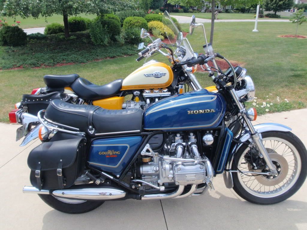

Hello everyone.  I bought a sweet Valk about a month ago.  I have put about 500 miles on it and everything is working great. I have changed the bags and removed the sissy bar since this picture.
