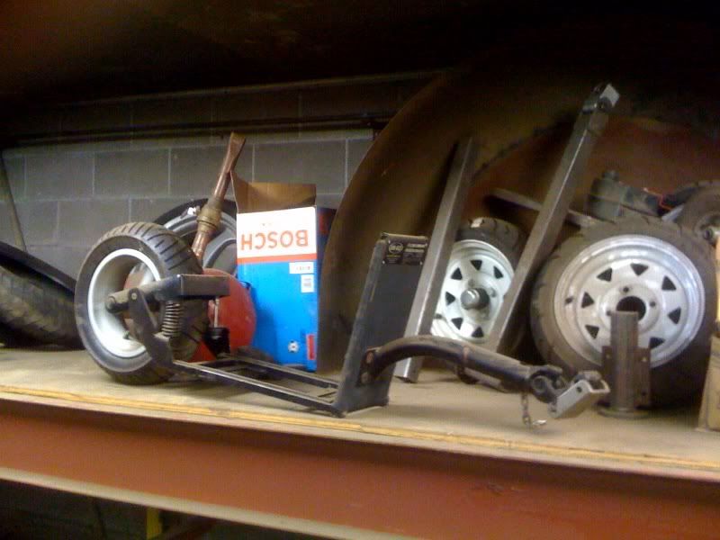

Just curious how many have made their own trailers. I like the store-bought ones, a lot, but just can't see a few grand for something that I'll only use a few times a year.
I've got all my parts except taillights, and that's only because I don't have $50 for LED lights. Don't want to use the incandescents, due to current drain. The plans I found use torsion axles, and 2" 14 ga. square tubing for the frame, with cartop carrier. I found that the two "exercise machines" that I picked up on the curb on trash day (people buy them, and find they're TERRIBLY hard to keep dusted...), have 15 ga. 2" square tubing, and more than enough for two trailers! I'm into the whole trailer for just about $300, which is good for me. Will look something like this:
So, anyone else built their own?
Any hints and suggestions?

Torsion axle suspension instead of leaf spring suspension, to all but eliminate bounce.
If you are looking to purchase a motorcycle trailer to tow behind your motorcycle, then you really should be looking to purchase a trailer that has independent rubber torsion suspension.
The advantages of rubber torsion suspension are many and include a longer life with smoother ride, durability, dampening effect, easy installation, and maintenance free and easy replacement.
Source: http://ezinearticles.com/?Motorcycle-Trailers---The-Advantages-of-Independent-Rubber-Torsion-Suspension&id=2693052
12" tires, instead of 8", for very obvious reasons. Better tracking, better wear, better angle to motorcycle, down instead of up.
18 cu. ft. instead of 16.5 cu. ft.
Steel instead of plastic fenders.
Fully welded instead of bolted together.
The HF also needs to have the tongue extended, to help eliminate sway behind a motorcycle, and a cooler rack installed.
List goes on and on...I did my homework.
Torsion axle suspension, and 12" tires adds about $150 to the cost of the $400 trailer. So, for $250 savings, I end up with a better trailer.

« Reply #23 on: August 10, 2010, 03:50:57 PM »
I made mine from one of those northern tool kits I've put thousands of miles on it and love it but I think it's a little over kill for a motorcycle. I seen hundreds of motorcycles including valks pulling homemade trailers headed down I 77 from the hillbilly into Virginia. Where's everyone gone? Must be a big ralley somewhere.
