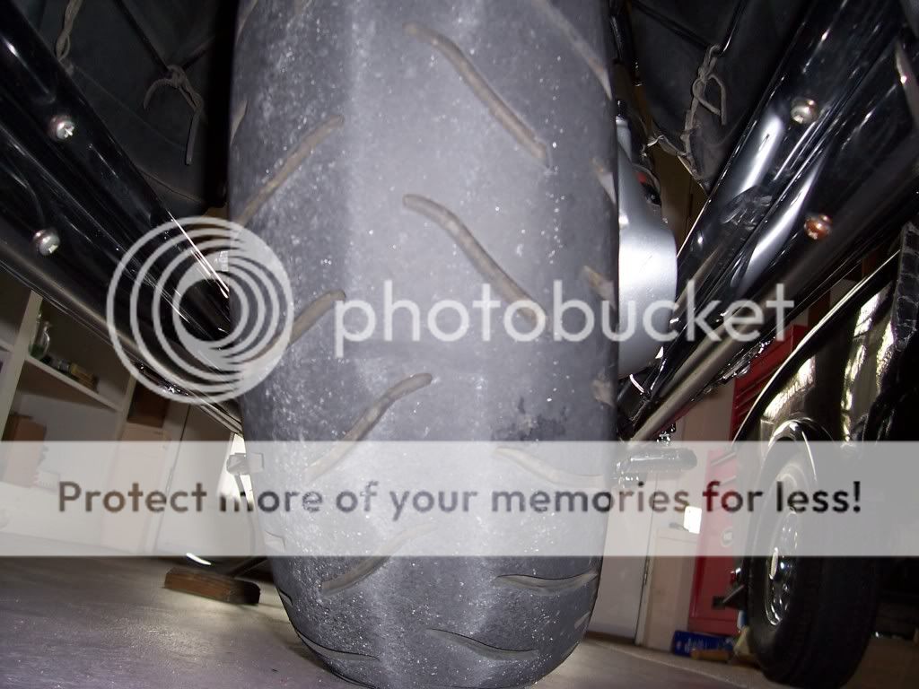

May be wrong but reading Chet's page it doesn't look like cupping. Tire has about 4,000 miles on it.
The tire has good tread but center 2 inches wide has an edge on each side  instead of being round.
I run 42 pounds and check it regularly. Any suggestions???

I ran the Elite 206 past 20K twice and now the E3 past 20K twice and Im on the third one and I expect more than 20k.  The last one actually went 23K before touching a wear bar.  I always run 42K and yes, unless I stay on twisty roads all the time they develop a flat spot after 10K or so, thats simply from running on straight roads, its normal tire wear

I've run Avons, Bridgestones and Dunlops on my 99 IS. All wore with this flat spot in the middle. It's just normal wear from driving on straight roads as was mentioned. Nothing wrong.

Nothing wrong with the flat spot, as was said, it is normal for straight road riding.

Some call them "Chicken Stripes", but that is not what they really are. It's really more of a reflection of what type of riding you do. Most motorcycles spend a lot more time upright than leaned over. The severity of the "lean angle" would only make the tire be used more up toward the bead, but unless you are road racing almost exclusively, the center still sees more wear. Just think about this: How often is the bike leaned over while using high torque for acceleration or braking, compared to the bike being upright during fast get awaways and stops? That is where most wear occurs. Just rolling down the road the wear is minimal unless you ride on extremely abrasive roads, or where a lot of "milling" of the road surface has occured like in construction zones. They are like riding your bike on a file or sandpaper.
Most motorcycle tires will show this type of wear during normal useage.

If I'm not mistaken many MC tires have a longer wearing compund in the center (about 2 inches wide) and usually as the tire wears it may leave a small step down to either side of the harder compound band.

My E3 developed a distinct center band with very defined left and right edges, leading me to believe that the E3 is one of the tires with a harder wear band in the center, no proof other than observation.
