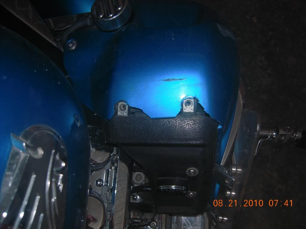

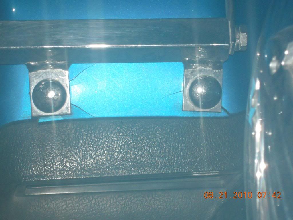

Here's a couple of pics of my pods and the damage caused by the Baker Air Wings.
This is a picture of my right pod.  It's the one that is totally busted out.
Here's a picture of my left pod.  You can see the cracks that have started around both mounting bolts.
NITRO
Posts: 1002
Eau Claire, WI
« Reply #9 on: August 21, 2010, 09:50:39 AM »
I was talking with a guy at the VOAI ride this summer that had the same problem with cracking from the wings. He sold his Bakers after that. I'm guessing the extra leverage the airwings put on the plastic, particularly in strong winds, is too much for the pod to handle. They obviously weren't intended to have all that extra weight pulling on them.
