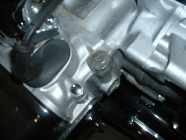

I cut the front tube, used freeze plugs, reused the two fittings that go on the bottom at the exhaust manifold and filled them with JB Weld (you might need new OEM gaskets for these two) and bought the petcock vacuum line from Redeye. (I also bought the Redeye Gas Line Disconnect but not necessary) Have less than $20 in parts. Freeze plugs don't look bad, especally if you have the Kury trans covers on. Done it the same way twice now, gets rid of a sh!7 load of parts (and potential leaks) as seen below

New vacuum caps & petcock line from Redeye {Great folks BTW!}, 9/16 cup plugs from local parts store, a big vacuum cap for thr nipple on the air cleaner, & some JB weld & my welder is what I used.
Chopped off the bottom tubes about an inch from the fitting, flattened & rolled the tube then welded it shut. Reinstalled them using red silicone to reseal.
Filled the cavity above the freeze plug then put nickels on the back 2 ports for decoration.
Cheap 'n easy, just takes some time! cooldude

Eddie's desmog kinda gives new meaning to the nickel trick, doesn't it..  Grin

« Reply #14 on: August 25, 2010, 07:32:54 PM »
That was the point of using the nickel Patrick! Grin
Paid over $5 for chrome buttons to finish off the ports on Kim's Valk.  Embarrassed  The nickels won't rust later on & they only cost.... well, a nickel each! 2funny
