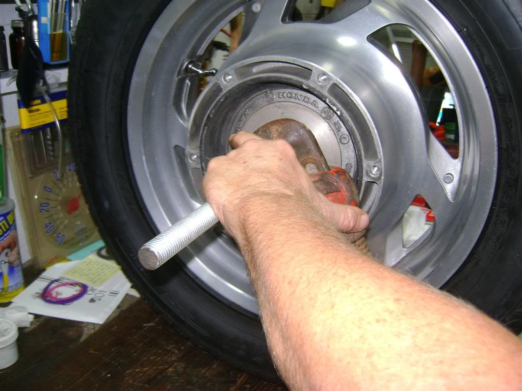

I had the collar/spacer machined down and now have double roll ( R ) side on the ( L ) . I've replaced ( 4 ) rear left bearings on my Valkyrie's since buying my first one 1998. When the other two need rear tires I'll be doing the same on those as well.First picture is the spacer after having it machined down. We made a collar to go between the spacer and dust seal and was able to use the dust seal also with alittle silicone sealant around the edge. I just got back from a 1,500 mile weekend ride doing the entire Natchez Trace from Natchez, Mississippi to Nashville , Tennessee and it looks outstanding.I also installed new dampers while I had the rear down along with spline and final drive maintence.
These last two pictures show's how we pressed the bearing's in useing two old left bearings as a guide.

« Reply #1 on: September 06, 2010, 02:31:03 PM »
Good pics Joe!
Got pics of what you did/how you used with the dust seal?

« Reply #2 on: September 06, 2010, 02:57:01 PM »
Good pics Joe!
Sorry Daniel I do not I put the bike together until 2:30 a.m. last wednesday night and hit the road thursday morning for Natchez, Mississippi. I'll check and see if I can get one with it on the bike.
NITRO

joe, how much did you machine off of the spacer when you went to the double row bearing?

« Reply #6 on: September 06, 2010, 07:19:11 PM »
There's a write up in shoptalk about it.
http://valkyrieriders.com/shoptalk/5204_bearing_mod.pdf

« Reply #9 on: September 07, 2010, 10:46:22 AM »
You may call it a dust seal but that is a misleading description!
It will not keep out anything but boulders.
It will not keep out water!
It may be better that nothing at all but losing the actual seal is the worst case scenario.
The part that you machine off the spacer is the part that runs inside the oil seal and you have to run without that seal when you change to the double row bearing!
Now there are those that will say that the bearing still has a seal incorporated with the bearing which, when you do the modification becomes the first line of defense.
Much better to keep the oil seal as the first line of defense and then the bearing incorporated seal becomes an additional line of defense.
If Honda even considered the Valkyrie needing a double row bearing at that location they would have put one there.  Some however think they are better at this kind of redesign effort.
I'll say this again for all those that are considering bearing replacement.  Most all bearing replacements are repeat replacements due to inexperience and lack of proper installation of the replacement bearings.
One fellow on this forum has replaced a bearing four times now. FOUR times!!!!  How often can you blame the bearing?
Keep the power washer away from that part of the wheel where the bearings are located and you should never have to expect to replace the bearings.  You should consider the bearing a forever item.

« Reply #12 on: September 07, 2010, 04:26:42 PM »
I know this is a redundancy because I have posted this information before but just in case someone hasn't seen it, here it is again.
Although I agree that the bearing seal should be sufficient, I too was apprehensive about losing the dust seal but I remembered something I had seen once before in the machine tool trade. It is a shield that covers the bearing and provides some additional protection. I shortened the spacer an additional .3 mm which is the thickness of the Nilos Ring. I used the 6204 ZAV Nilos ring below. Can be picked up at most bearing houses including Motion Industries for around $10. It provides some additional piece of mind about losing the lip seal. I have had it intalled for 4000 miles and no problems. I will be doing it to my I/S as well on the next tire change. To me this is a no brainer if you are doing the "Double Row Mod"
(XRing, feel free to pipe in here if you have installed the Nilos ring I sent you and agree with this concept.)
Example bearing with Nilos installed
Nilos catalog page and web address:
http://www2.nilos-ring.com/Default.aspx/G/111327/L/1033/R/-1/T/122948/A/2/ID/122949
Shorten spacer to this dimension if using the Nios Ring. This is .012 shorter than the writeup in the "Shop Talk" article)
A bearing with and without the Nilos Ring. As seen, it provides a metal cover for the plastic bearing seal. It is only .3mm or .012 inch thick. It is clamped in by the shortened spacer against the stationary inner race and has a close running clearance with the rotating outer race.

« Reply #14 on: September 07, 2010, 06:02:56 PM »
It's hard to tell from any of the pictures I've seen on this subject but once the double roll bearing is installed is it flush with the wheel or is it beyond the wheel hub ??

« Reply #16 on: September 07, 2010, 06:36:50 PM »
I recall that it is is very close to flush or just a little inside of flush. That is why when the double row bearing is installed there is no longer room for the dust seal that shares the bore with the single row bearing.

One other thing came to mind on this subject .... when making the mod to the spacer to be sure it is done by a qualified machinist to get that new mating surface on the spacer nice and square with no axial runout.
I had mine machined at a business thats famous in our area for building race car motors.

i must be having trouble understanding the article on double row bearing install.  could someone please give me these measurements:  1- how much do you machine off, and 2- what is the final measurement of tle machined down spacer?
Posts: 13846
« Reply #31 on: September 11, 2010, 04:34:53 AM »
If you plan on doing it then buy a new right rear bearing ( double row ) . Take it and the old left side that's to be replaced to the machinist...Take off the difference between the two on the spacer .

The article says to remove .26". It's all in there!

It's actually not that big a deal since the swingarms are a fabricated item that also have a tolerance range.
The difference in the amount you take off just needs to be close to the difference in the bearings.
within 30 thousands of an inch either way will work just fine!
You make a good point, but, +/-.030 is a little excessive - I would try to keep it +/-.010 myself

SmokingJoe,
I had thought about using the sealant to hold the seal in place on the rim also, but was unsure if it would work very well. Undecided
Just wondering which sealant you used and how well did it hold the seal in place on your trip?

So far so good....We made a collar out of plastic that's between the spacer and seal to hold it tight to the wheel.I put a very lite coat of sealant on over the entire bearing and let it dry. The dust seal was packed around the inside edge with water-proof Green Grease and the outer edge was sealed to the wheel with NAPA Silicone Adhesive Sealant ...I've rode it about 1,500 miles since the install and it still looks as stated above ....So far so good.....I'm ridin' it today across The Great Smoky Mountains I'll try to see what kind of pictures I can take without having to pull the saddlebag off.
