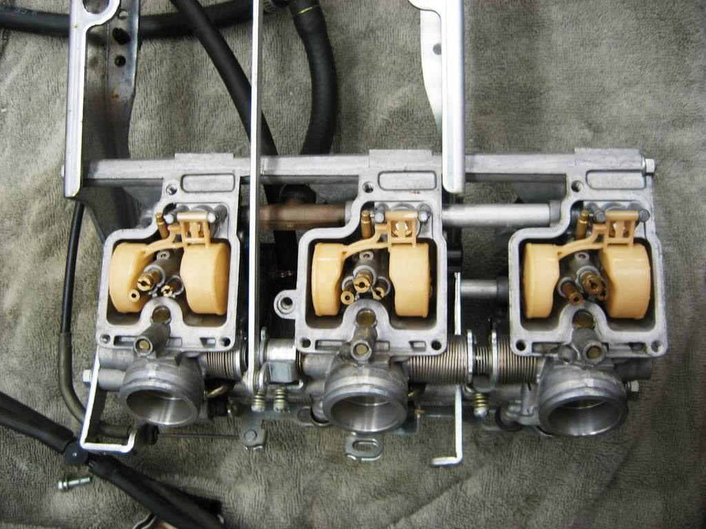

« Reply #9 on: September 24, 2010, 05:52:13 AM »
If the cleaner does not work the jets are easy to replace. I removed the carbs, cleaned replaced the jets and reinstalled and synced the carbs in lesss than 5 hours.
The inside of my carb bowls looked like this
The slow jets are the round brass in the middle lower right of the float area with the slot cut in the back.
I also removed the pilots, and floats. Let it sit with Gumout for a while and used compressed air to clean everything out. Ran like a new bike.
Like stated the jets are much cheaper at Chapparal racing than the dealer.
