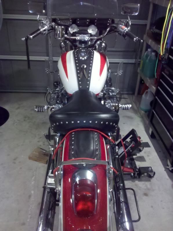

Started to go for a short ride today.  Right after leaving I started hearing sounds like I've never heard before.  Didn't go far and went back to the house to take a look.
It sounded kinda like a popping noise with a few snaps and crackles thrown in coming from what sounded like the rear brake caliper/left wheel bearing area.
It would do this out of gear and just coasting.  What's weird is that when I applied the rear brake, it sounded like the rear brake caliper was chewing rocks or something.  The chewing rocks sound from the brakes being applied would lessen up and just about stop completely when I let up off the rear brake.  However, there would still be the occasional rice crispys sound.....pops with some snaps and crackles....all of this coming from the left/rear side of the bike.
On the way back home, I tried to take a cell phone video trying to document what I'm hearing.  Just ignore most of it untill about the 1:50 mark and then start to listen.  Maybe you can tell what I'm talking about.
Brake caliper noise?powered by Aeva
After I get home I lift the bike and start looking at the rear caliper.  Took it off and haven't found anything wrong with it (the pads are fairly new.....and no problems with it up untill this point).
So with the brake caliper safely hung out of the way and the rear brake pedal strapped so it won't move, I take the bike back out just in front of the house real slow trying to check it and and isolate what's making this noise.  There's still this snap, crackle and popping noise going on.  It doesn't appear to be the rear brake caliper now since it isn't even mounted and hooked up.  Sounds like a bad bearing maybe.  I don't know what else is down and around in that area that would make a noise like that.
Lifted the bike back up again to take another look and just spun the rear wheel by hand.  This is what I heard......
Left rear wheel bearing noise?powered by Aeva
What else could this be......the dreaded left rear wheel bearing?
What does a bad rear wheel bearing sound like anyway?

« Reply #6 on: September 25, 2010, 05:46:55 PM »
donald.....
It's a red & white '97 Standard with 44,441 miles on it.  I've had it a little over 2 years now.  Bought it with about 32,000 on it in early June '08.
« Last Edit: September 25, 2010, 06:35:27 PM by BF » Logged
