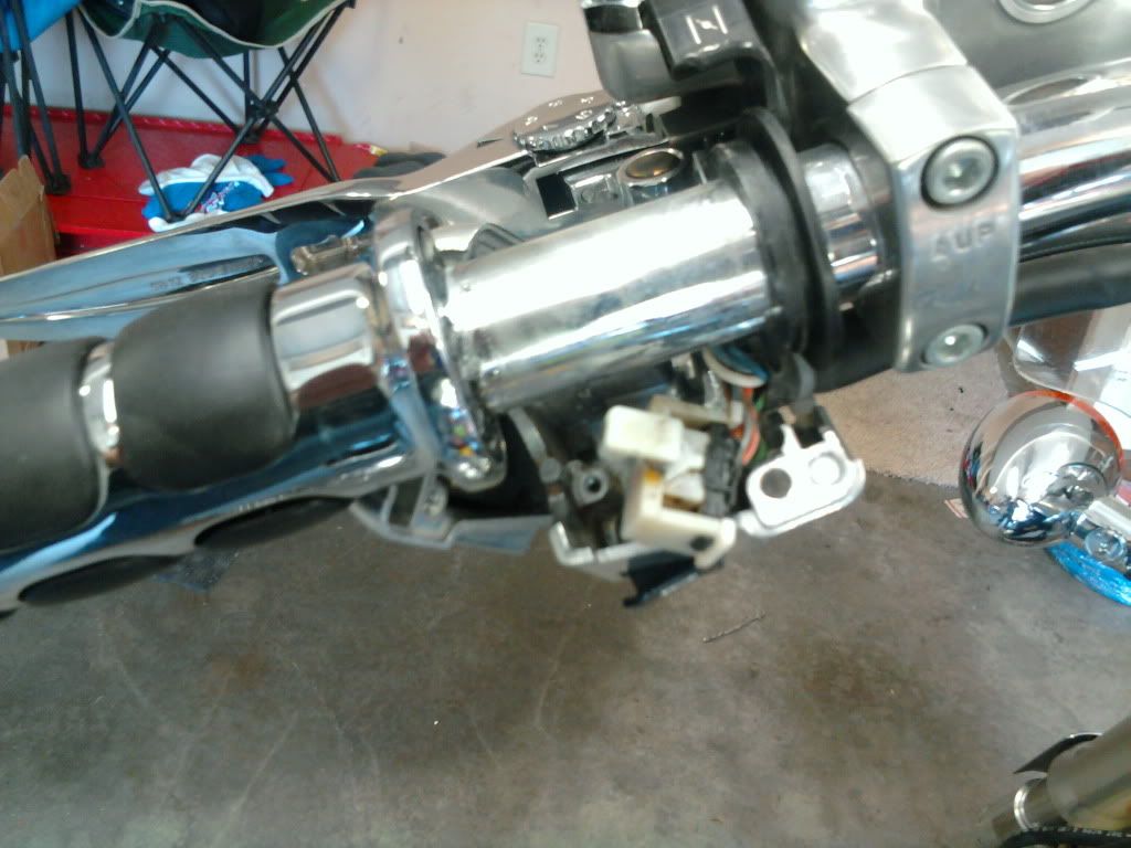

« Reply #9 on: October 09, 2010, 07:27:39 PM »
I just serviced this on "bark2's" bike.  He said that when it would warm up in the afternoon they would work.  i checked the flasher and it was good, and the switch wasn't "tough" to switch left and right and push in but their was  a significant delay in the turnsignals coming on.  I took a few pictures of what the switch looks like apart but I can't seem to post the pictures... Will try in the morning.
yes clean and re-lube... works great now  cooldude

stude31
Posts: 1100
Topeka,ks
« Reply #12 on: October 10, 2010, 04:22:47 PM »
Alright here are a few pictures:
On this second picture you can look and see that the black piece that is on the right side will "pop" out of the white piece if you squeeze the black tabs in and pull it apart.  I didn't take a picture after those two but pay attention to how it comes apart.  If you are not sure you can always take the copper piece and turn the key on and see if you have the alignment correct by sliding the piece back and forth and watching the turnsignals come on or off.  If they don't then you have it upside down.
hope this helps.
