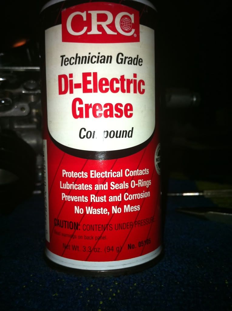

Bought my Tourer in 05 and found this Tech site wanting to learn as much as I could about my Valk. CA and Airetime were members then and always giving help to us that ask.
If I was going to coat an intake O-ring I would use a thin film of the Dielectric grease.
With Viton O rings it may not matter what you use as lube.
For Buna O rings mineral oil or grease will cause them to swell slightly giving a better seal.
If no swelling is desired use vegetable oil. Not sure of the effect silicone grease would have.
Need to ask the question of some suppliers on that one.
Cheers Steve
I like to use vasoline for O-ring installation.

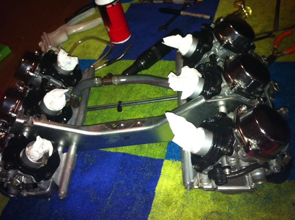

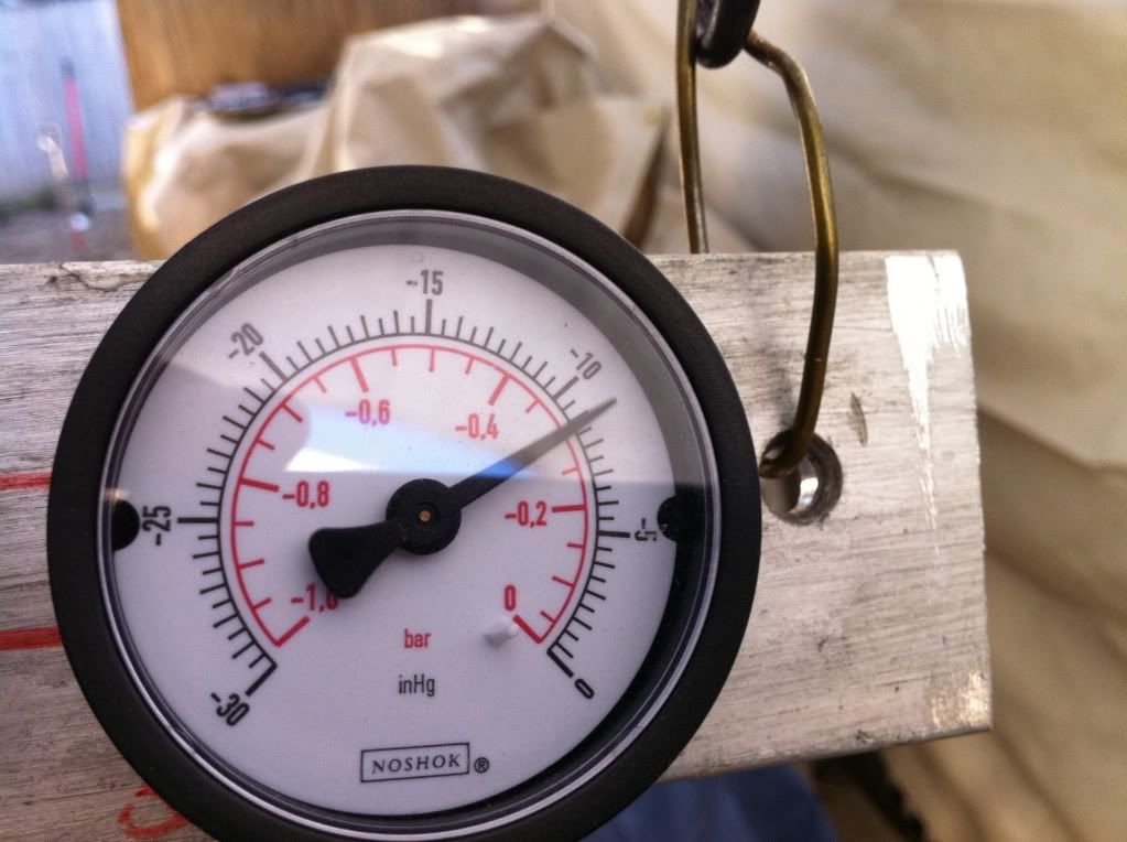

Update as of 4-26-2011
Ok I got the carbs all gone through again, did not find very much really wrong.
the Air Cut valves are a little out of spec from what info is provided by Rich at Red-Eye (this is from his documentation I did not call him for more info so it may be interpretation) says that air should pass through valve freely and when 15in of vacuum is applied they should cut off the air flow.
Well maybe my Mity-Vac is wrong but I only had one that shut off completely when 16in was applied and the other were shut off from about 18in -19in so I think that is probably OK since what is the likely hood of all of them really being bad? So I just pulled everything apart and cleaned with spray carb cleaner and blew everything out with compressed air and used the Dielectric grease as suggested on EVERY rubber component installed new rubber pieces including the intake boot between carbs and intake tubes.
I did fine 1 mixture screw adjusted WAY wrong,, it was almost 4 turns out, dummy me did not re-check all of them only the last one I worked on, but I did make 100% sure they are all at 1-3/4 turns out. All the jets looked clean and would pass air through them but I pressure cleaned them anyway.
I also noticed that the intake boots all looked like they were pinched a little bit  in one area (kind of bunched up) I guess I managed to get the clamps off of the little location nub/nipple. This would explain an air leak.
Hopefully I will get the rest of the fuel system installed this week and fire her back up by the end of the weekend.

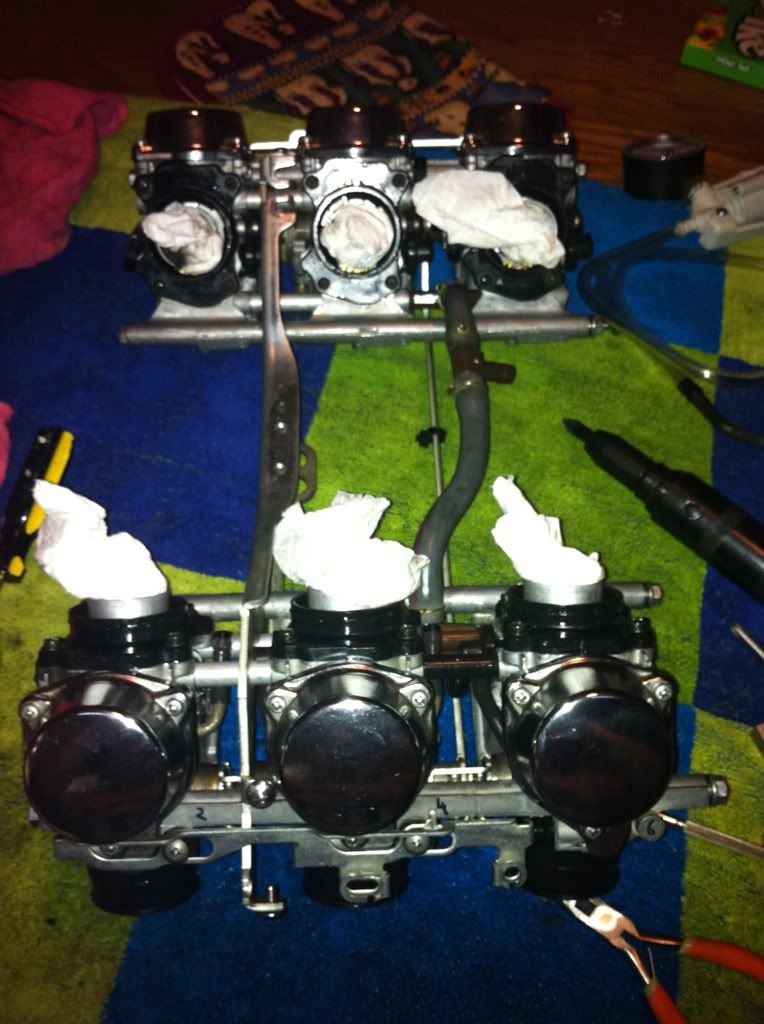

She breaths fire once again,,, first off NO I do not know for sure exactly what was wrong but it seems mostly fixed now.
There was only one thing that I ran across that really seemed that it would be a culprit and that is the 1 Pilot screw that was set out at around 4 turns,,, Well I only thought to check this on the very last carb I dis-assembled (dumb on me) anyway I don’t know how I had this one so far out and I also don’t know if maybe there were others adjusted incorrectly. I also am not sure if maybe I had a air leak at the rubber boots between multiple carb throats and air box bottom, also I had 1 intake O-Ring that looked funny when I pulled it out of the groove. The only thing that was specifically done differently was I used silicone Dielectric grease to hold ALL the O-Rings in place and help seal them. It even said the Dielectric grease was and O-Ring sealer, look for yourself.
Look closely it does say it "SEALS O-RINGS"....
Now here is the full rack re-assembled and cleaned and even lubed up on all parts that contact any rubber surfaces carb throat and exit I also picked up all new rubber boots that sit between carb and intake runners, there were some that did look like they had been squeezed funny on the inside.
And here is the video from the first fire up I had a little problem with the Dan-Mark fuel valve. I just could not get fuel to the bowls even opened the drains to verify if ANY fuel was getting to the carbs. Nope no fuel ok stick my ear down close nope no click of the Dan-mark valve opening when key is turned on.  Verify I have 12v+ at the supply from aux panel, yes full voltage, ok use a needle to puncture the wire close to the valve and yep 12v+ there also so lets check the ground side,,,,,,,, OH HELL, I found that I had originally used the same screw that holds the forward coil to the frame and this time it had slipped behind the frame and I missed it. So I attach the ground wire and hit key switch Yahooooo the valve clicks open and closed now with the key. Pulled the temporary fuel line and put the Dan-mark pack inline and installed the fuel tank opened petcock and turn key switch on and gave it  a second hit the starter button, COOL she fires up little rough idle and a fare amount of bluish smoke from both sides. But it will run now at any RPM.

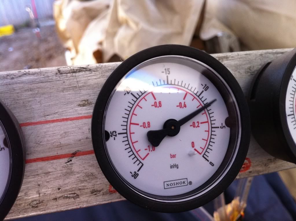

« Reply #209 on: April 30, 2011, 08:30:14 PM »

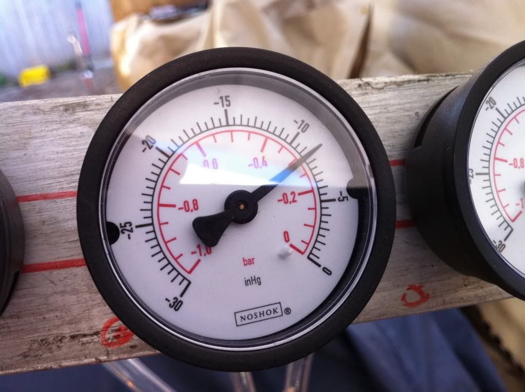

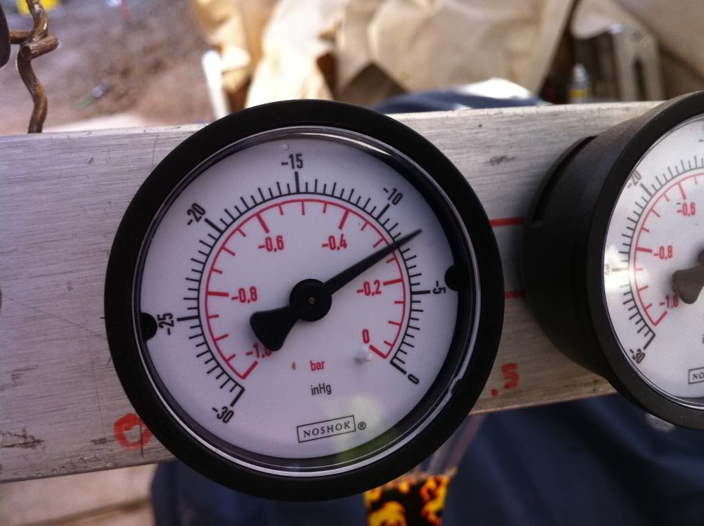

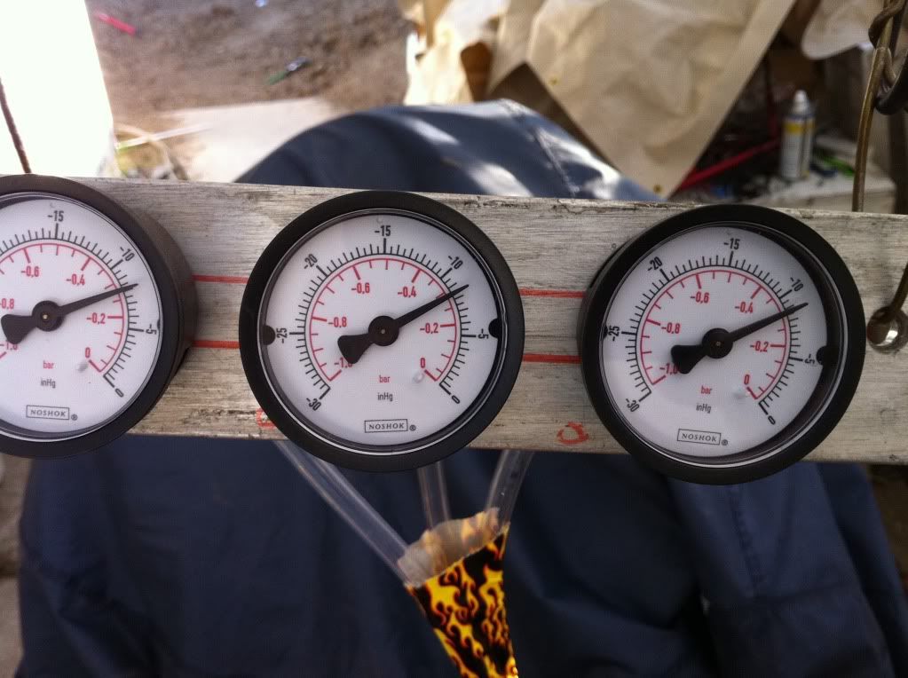

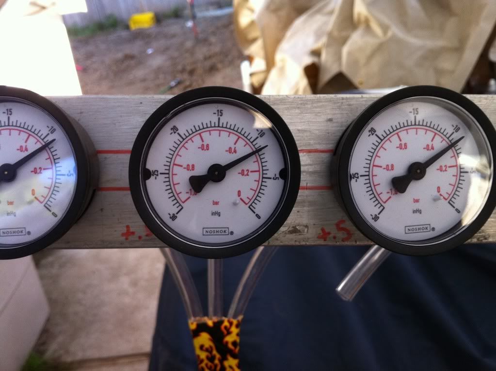

Getting back on track "AGAIN", I hooked up my home built Synch gauge setup and started her up this afternoon.
She was actually very close only had to touch 3 carbs at all and each of them were moved less than 1/2 turn.
Here is the right bank.
Cylinder #5
Cylinder #3
Cylinder #1
Those look fairly close.

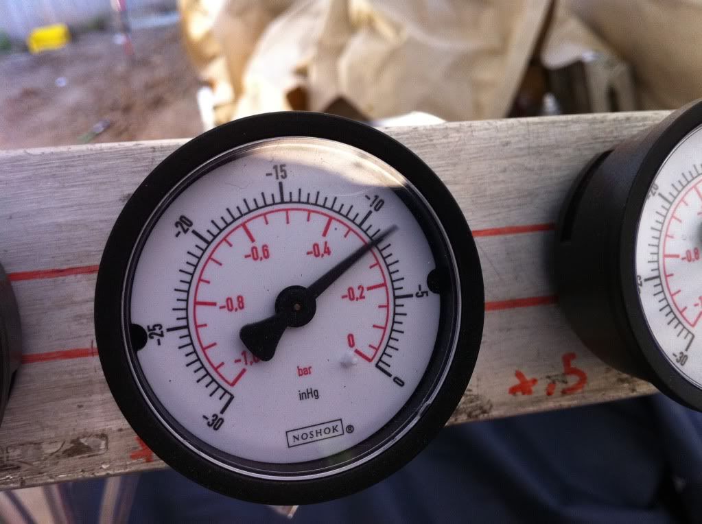

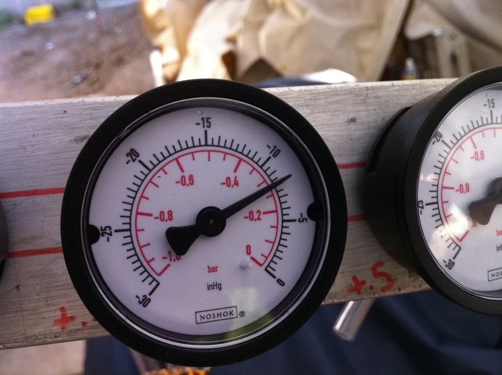

And now for the Left Bank.
Cylinder #2
Cylinder #4
Cylinder #6
Again they all seem very close this is a nice starting place.

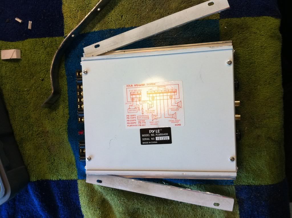

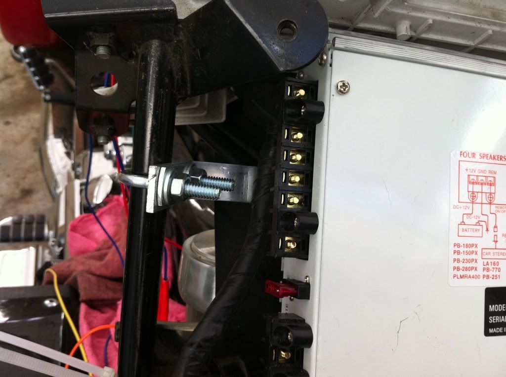

Amplifier install has been put on temporary hold just too much going on right now at home and I really need to get back in the wind with my FatLady. So I will be finishing up with the cruise control today and the Kuryakyn LED volt meter and get the bike off the jack and the jack stands really praying to ride her to work tonight. Be back in a little bit with a few more pictures of the crisis control and the buttoning up of the pods and fairing. I will be back at the amplifier install maybe this coming weekend.

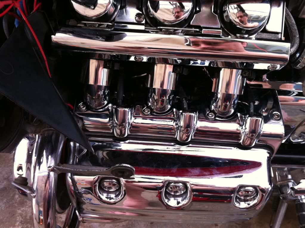

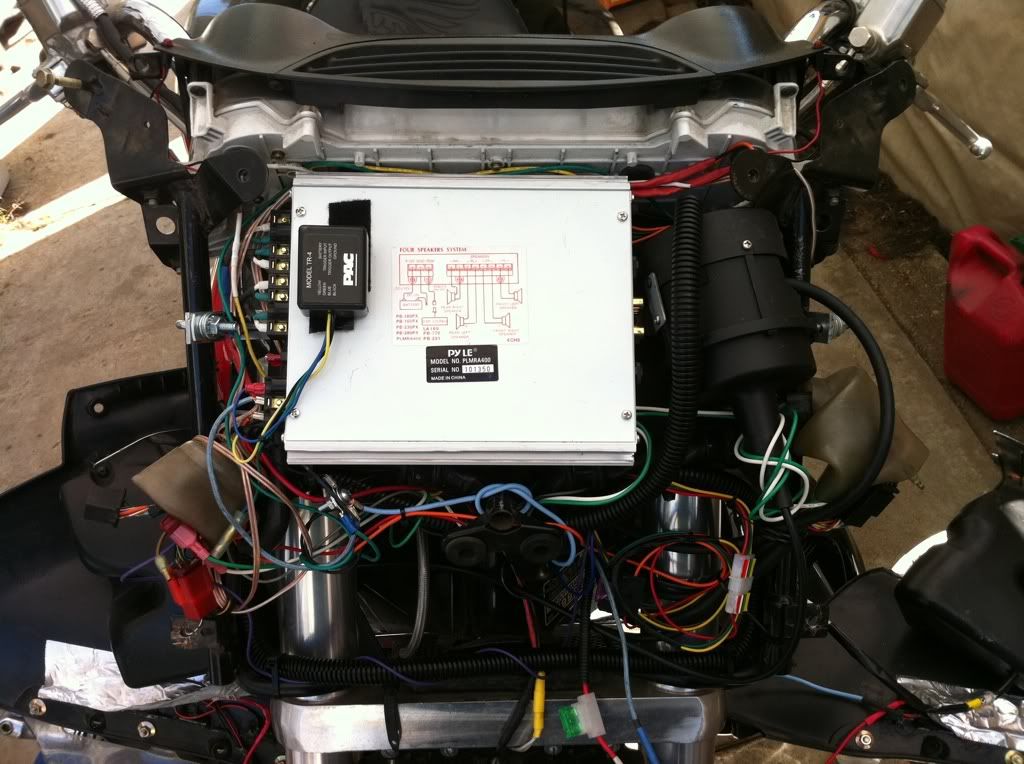

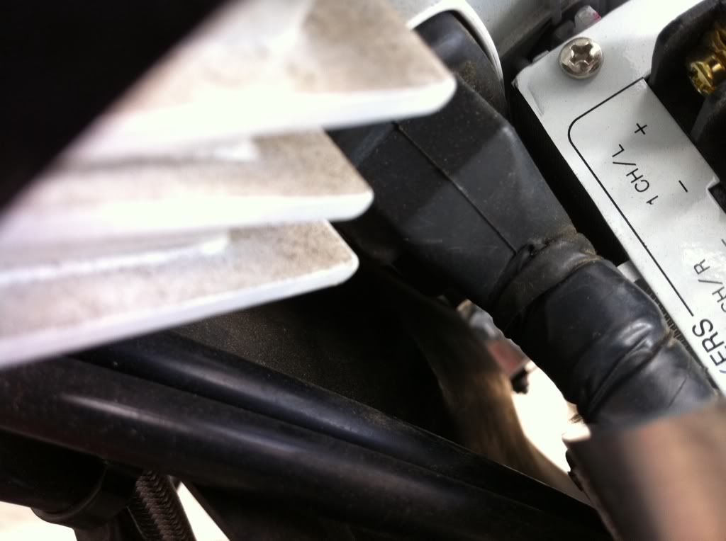

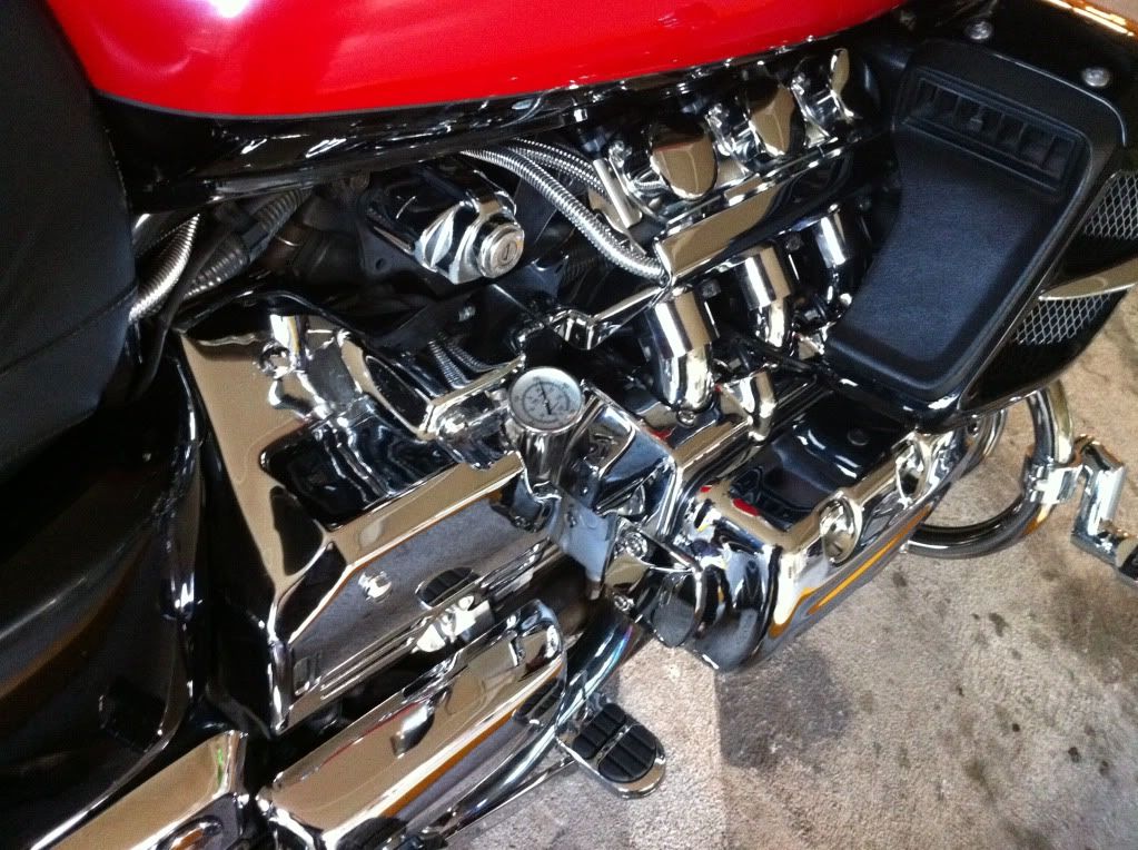

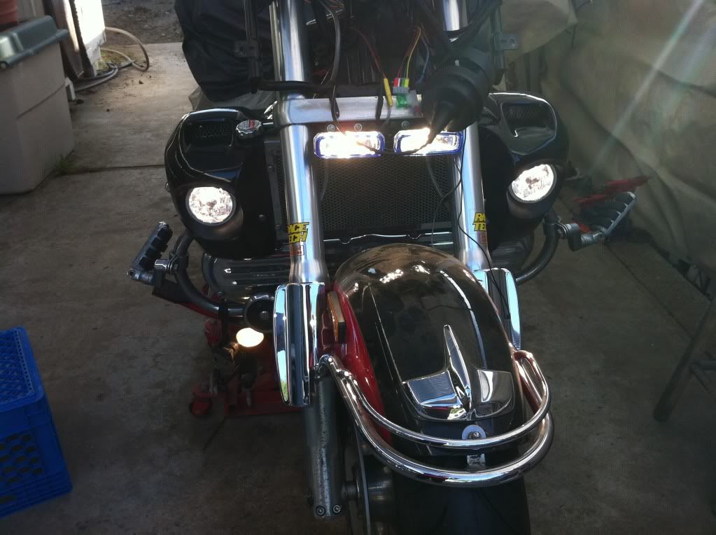

Here is what was accomplished today, not a lot but it sure seems like everything really takes about 4-5 times as long as it does in my head.
So let’s get the primary items that I promised to get done listed up here.
(the cruise control was not touched today as expected)

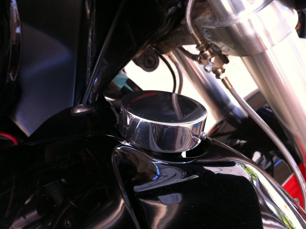

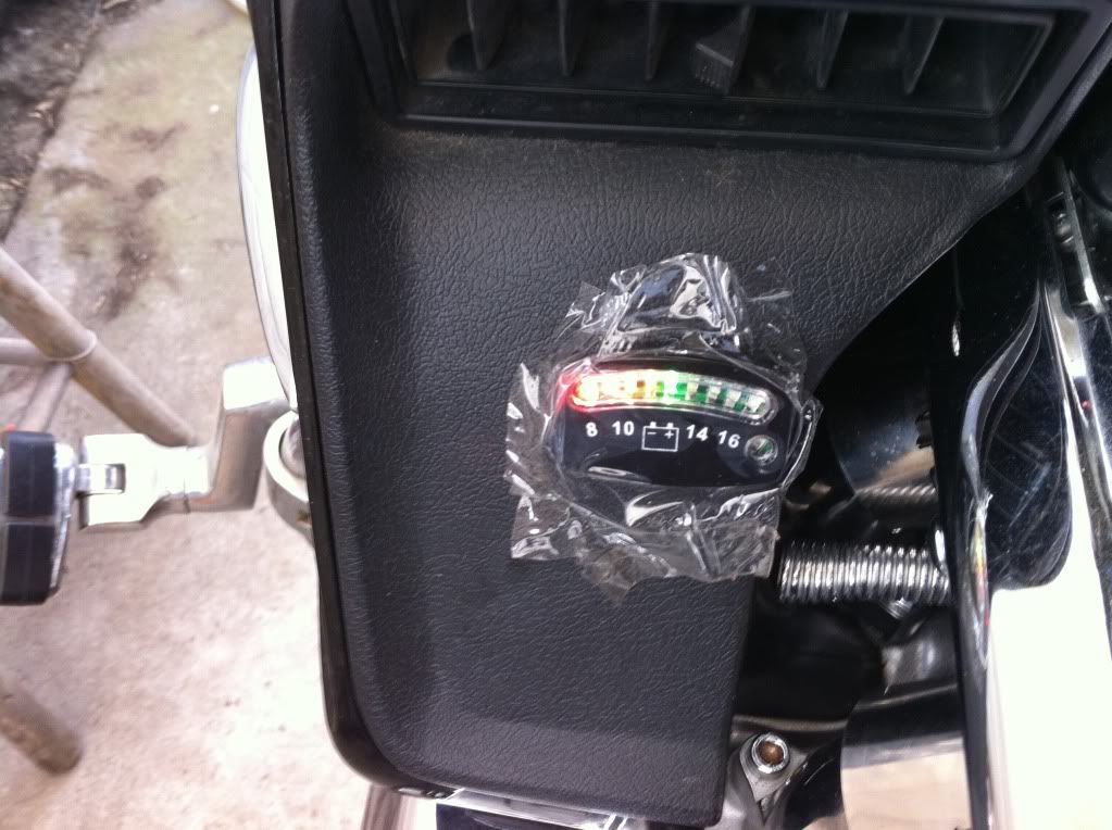

The LED voltage meter as you might remember I moved my factory installed Fog/Pod lights switch from the left pod to the 3 switch panel I installed on the brake master cylinder reservoir.
Well here is the LED Voltage meter installed and powered up, I left the plastic wrap on it for now until I get everything done so it will look new as long as possible may it only be a few extra days.
I picked up my ground on the frame near the mount for the forward coil mount easy and out of the way from anything.
Figured I would go ahead and install the chrome on this side but I have decided to wait to install the chrome spark plug wire covers for now I will address this later since the other side is a bit boogered up I may need to replace both sides with a new set so why do the install twice right?
And now for the lights all on picture.
And here is the look from the front,,, Gotcha this is just to prove the replacement PIAA bulb was installed in this FOG/POD light the other side is still fine so I only swapped this side out for now, and got the Volt meter installed and the POD back fully in place.
Here is the picture of Both PODs back on and all my extra forward lights working again. I was having a little trouble with the set below the triple tree found I had a bad connecter at eth aux power panel coming from the supply relay that feeds the switch that controls this set of lights.

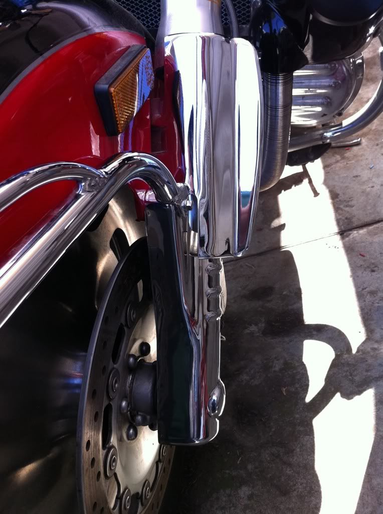

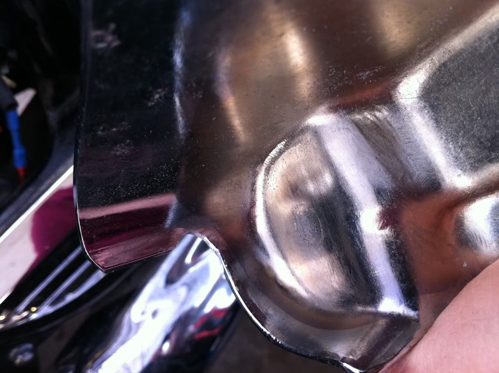

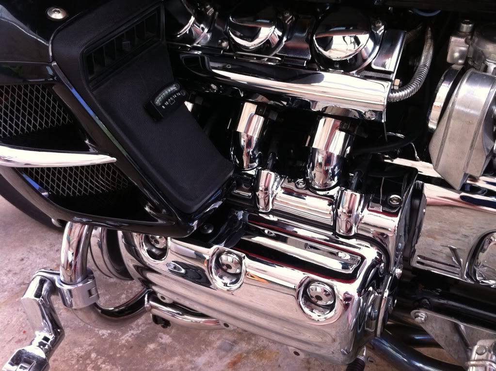

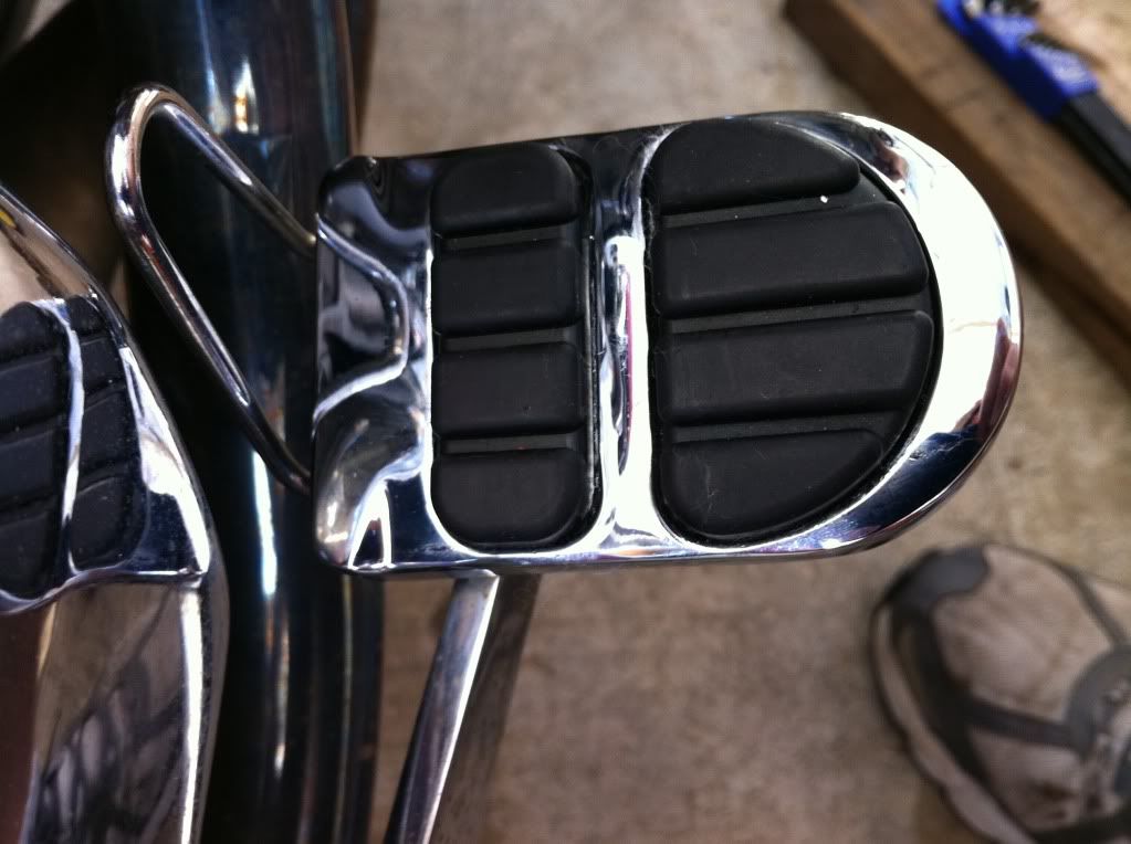

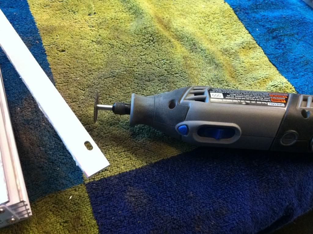

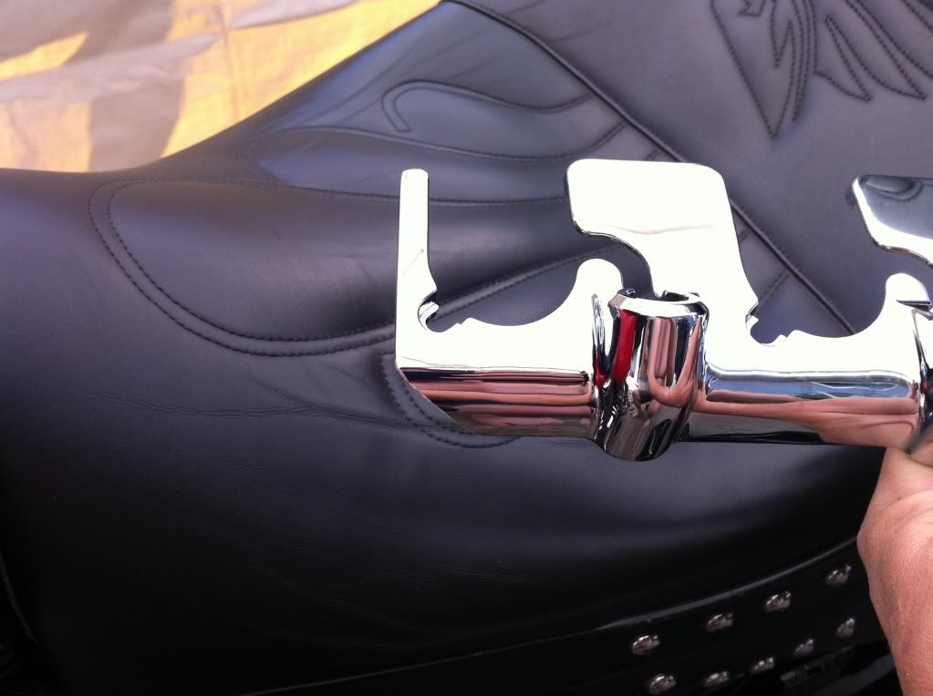

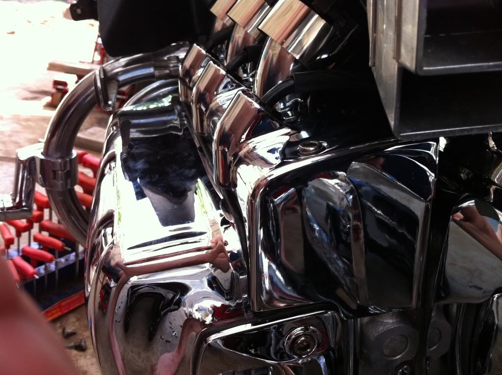

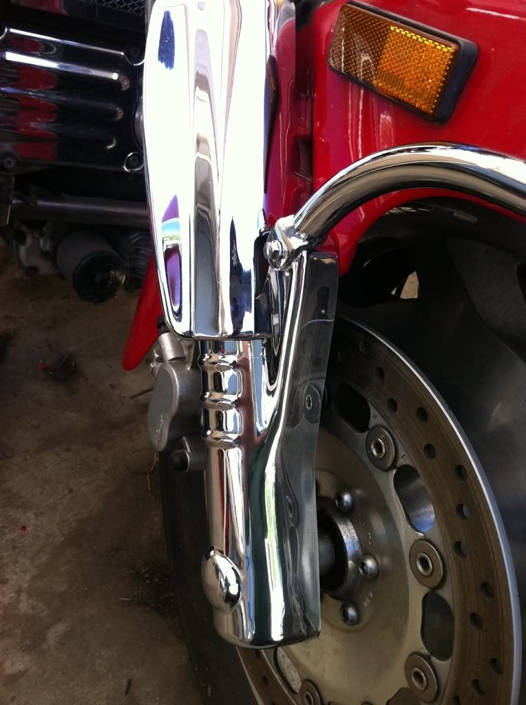

Ok I went ahead and got another piece or Chrome re-installed.

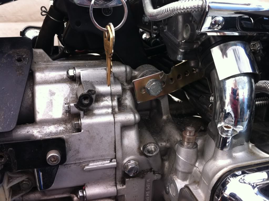

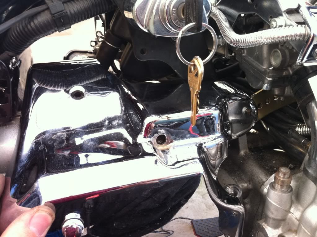

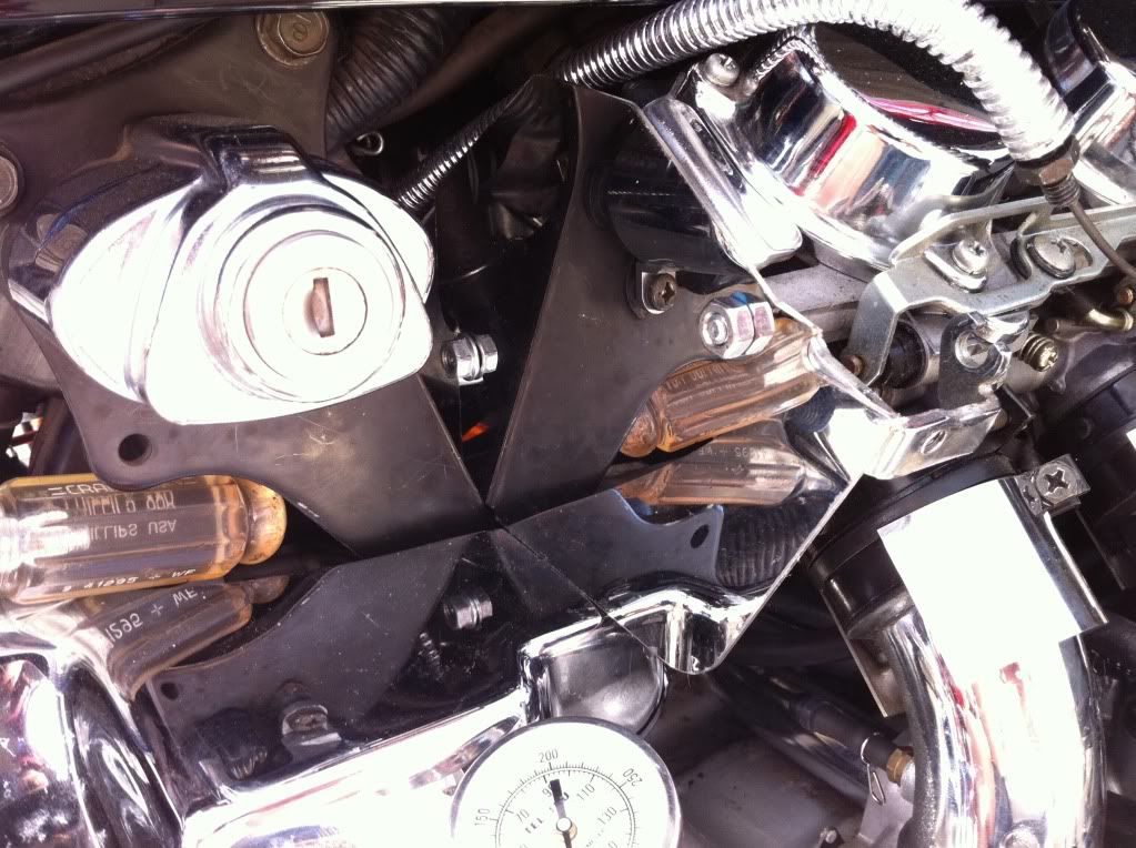

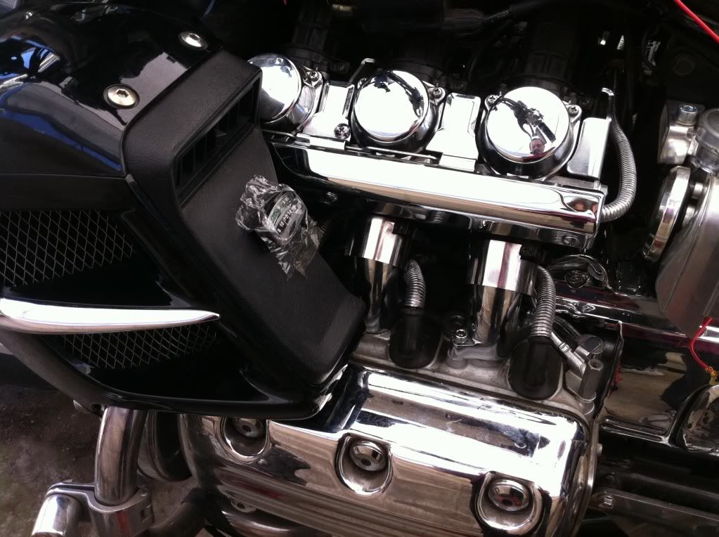

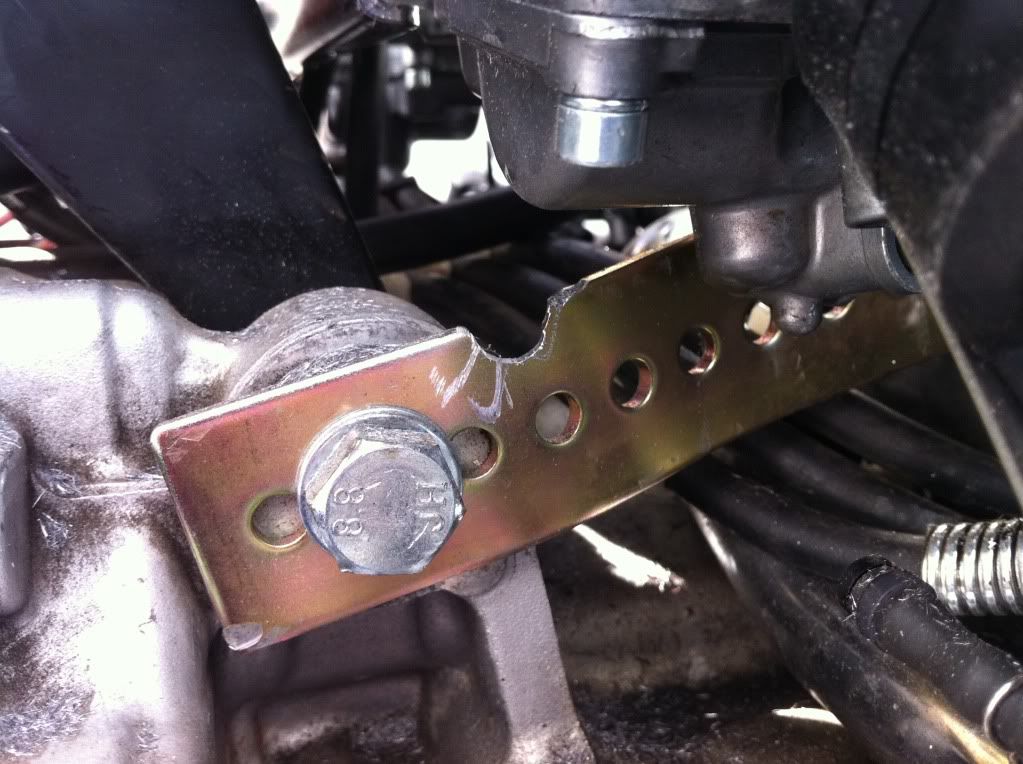

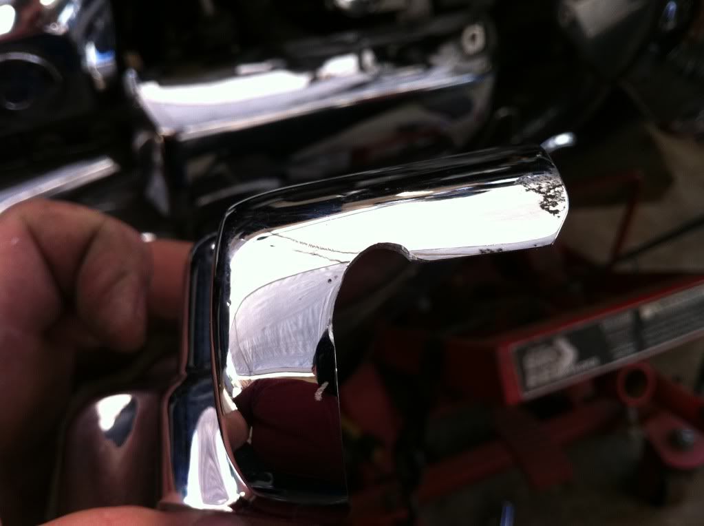

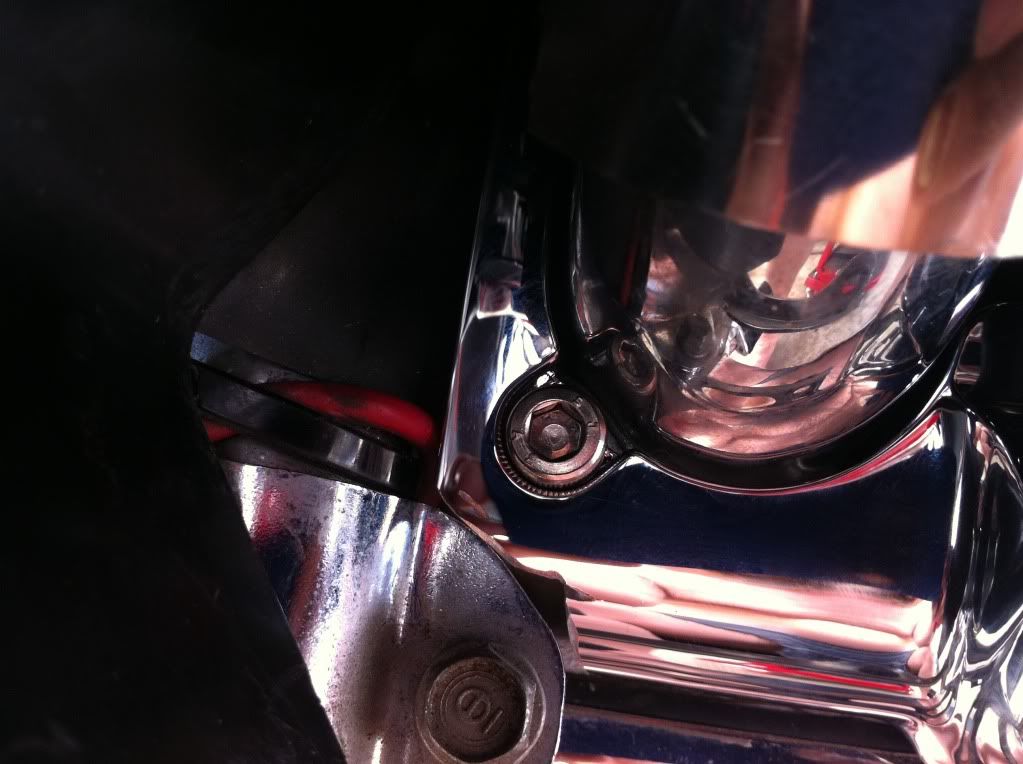

Being the ever so SMART type of guy I am I installed the cruise control cable in between CARB 3 and 5 as many other have done but I used the bracket from the motor mount and not the "L" bracket that many others have done. Well with doing this and not having my chrome Tranny/starter cover installed I found out the hard way today when I tried to install it that it WILL NOT fit with my current bracket in place. SO either I pull a BUTT load of stuff back out and curse myself with that damn air box again or pull out my trusty Dremel tool. I voted and won with the decision of using my Dremel and relieving the areas I needed to.
I will try and let the picture explain what went on but if I can think of anything that might add to a picture I will surely type it into place for you.
Can anyone see the HUGE MISTAKE I made while using my Dremel (rotary tool).
This next picture might help you see my oops, Yep I removed my oil/Temp dipstick and did not cover up the dipstick hole. I ran a small magnet down the hole after I realized the hole was lightly covered around it with metal shavings.. I guess an oil change is the first thing to do after I get the bike off the jack stands.
All better now I even used rubber O-Rings to help buffer the vibrations that some have spoken of that sometimes come from these Chrome covers.

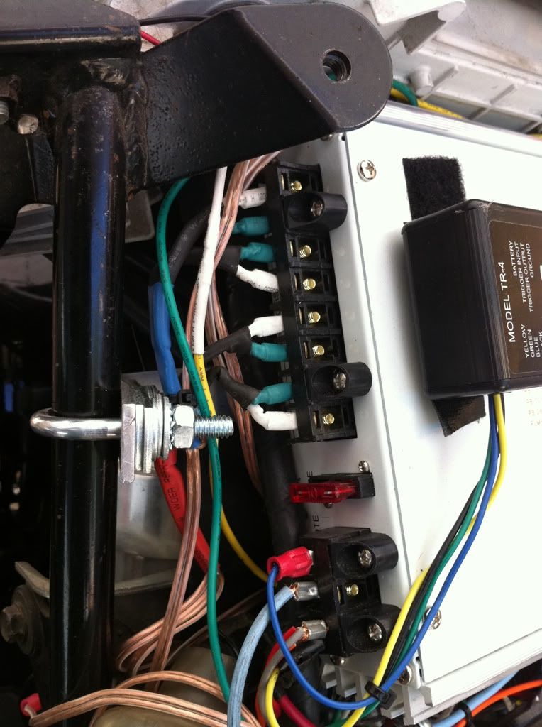

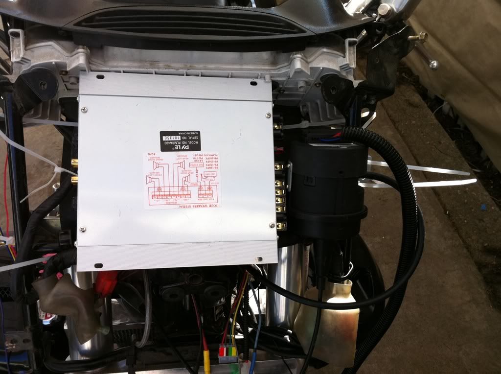

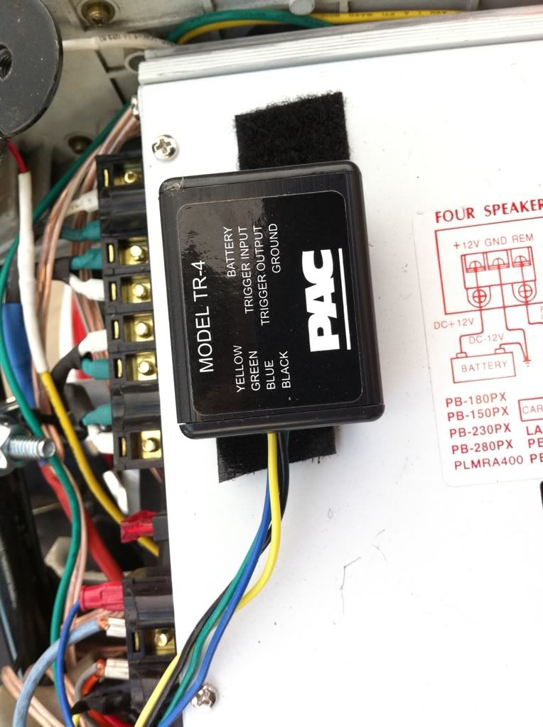

« Reply #218 on: May 26, 2011, 03:57:29 AM »

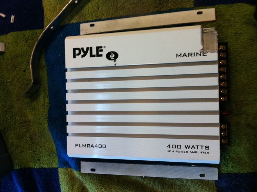

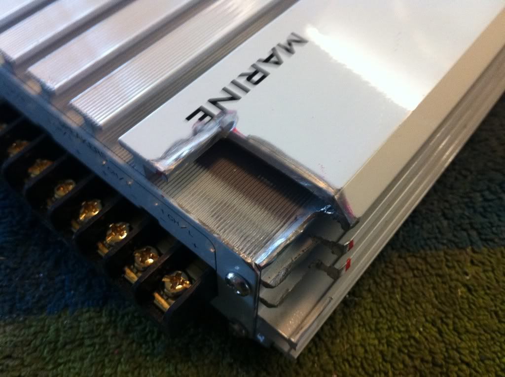

Here is what the amp looked like before I did some modifications for space and attachment purposes.
And here is the start of mods.
« Last Edit: May 26, 2011, 10:26:22 PM by fordmano » Logged
83GS550
93XR650L TARD!
97WR250
99ValkyrieI/S Tri-tone
01YZ125(x2)
05DRZ-125
fordmano
Posts: 1457
San Jose, CA.
« Reply #219 on: May 26, 2011, 04:15:23 AM »
I ended up ditching my first mounting platter, just could not get it figured out in a way I was happy with and after trying the last time to re-mod it I had stressed the aluminum too much and the edges and mounting ears started breaking off. So gone it was, and then I figured out I could use a small screw turned upside down and some washers and nuts in the creases between the cooling fins on the amp for a mounting tab instead of the side flaps that normally are used. I also figured out I had to relieve some of the cooling fins to fit snuggly over the wireing cable for the I/S dash panel.
And now this is before I figured out I had to rotate the amp to give speaker wiring clearance so as to not pinch or break off from contact with the Cruise Control unit.
This is the side view of the newly designed mount and the amp side wired up.
I dont know the proper name for this or what you might prefer it called but I call it a soft on switch basically relay that pickes up the low voltage on a speaker wire then sends a signal to your amp to turn on with a 2 second delay to prevent the evil pop noise.
« Last Edit: May 26, 2011, 10:27:26 PM by fordmano » Logged

« Reply #224 on: May 26, 2011, 10:07:05 PM »
If you would like to view ALL of my pictures here is the link to the photo album. Some may enjoy some may not. PLEASE BE WARNED THERE ARE OVER "780" pictures.
http://s974.photobucket.com/albums/ae222/fordmano/Valkyrieupgradeprojects2010/?albumview=slideshow&track=share_email_album_view_click
This is setup as a slide show but you can probably figure out how to browse the entire album if you really want to see it that way.
I thank you all from the bottom of my heart for all your support and I thank you for following along during this adventure, this has been my largest project ever undertaken other than trying to start a family.
« Last Edit: December 05, 2012, 01:59:16 AM by fordmano » Logged

« Reply #231 on: May 28, 2011, 12:46:05 AM »

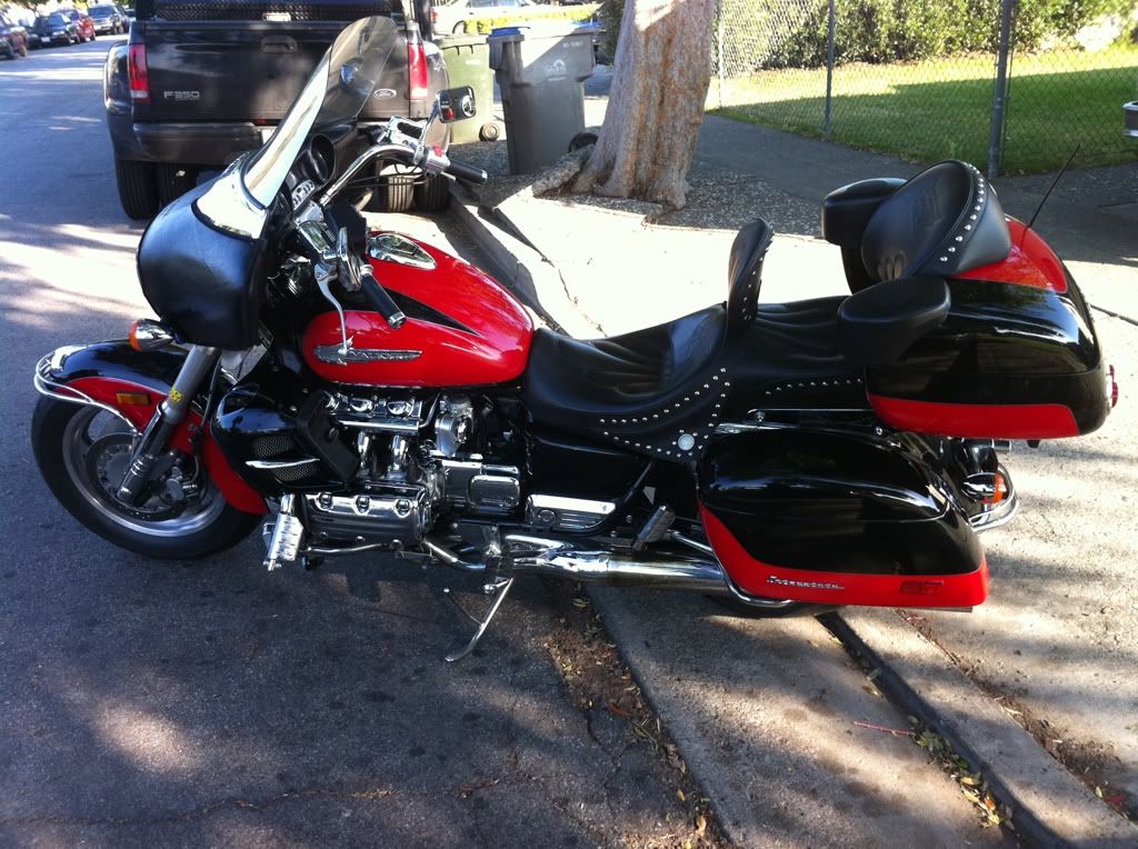

So as yesterday passed I was able to get the bike all washed up, could be a bit shinier but sooooo much better looking than it has been in almost 7 months.
Around 11:00pm I finally took the big girl out. The family decided it was best for me to sleep in the morning since I had just done a full shift at work. Then when I got up it was bike detailing time. Found a loose connector on my aux fuse panel. It turned out to be the fuse socket it self in the sealed fuse panel. Damn how to fix that since I can't get inside of it now? How about a little tweak on the blades fuses legs so I ever so slightly twisted both sides so I think that is all taken care of,,, it was the circuit that supplies the power to my amplifier,, that was a gotta fix it item.
Well above 3,300rpm or so this big girl knows how to pull. BUTTTTTttttt from just off idle up to that 3,300 area she is only running on 4 or 5 cylinders at least that's how it sounds and feels. Figure a bad slowjet. I filled the tank with fresh 91octane and a full bottle of Techron ran her around for about 1/2 hour in the neighborhood and tried to keep her below 3k but that was hard to do. She was really impressive above 3,500 all the way to RedLine. I will let the Techron soak in over night and see how she is in the morning. Oh, idle is perfect sounding and feeling but RPM's increase better than 300 after full warmup, that leaves me at around 1,300-1,400rpm idle speed.
I did get some popping on Decelration so I guess I better check exhaust nuts also. The new suspension seems almost perfect, maybe a few more lbs in the 416's and I managed to forget the check tires air pressure so I need to do that also in the morning.
Pictures of full clean up and everything installed as I would if I was commuting on her, probably tomorrow night for some new shiny pictures. Maybe I can get the wife and kids to get an action picture on the Highway?
« Last Edit: December 05, 2012, 02:03:22 AM by fordmano » Logged

20)   Install Chrome accents on Intake runners. (DONE)

32)   Install new Voltage meter. (DONE)

36)   Install Chrome fork leg lower covers. (DONE)

1)   Install cruise control system. (partial) need to hook up the vacuum line, have a “NEW” idea how this might be done so I need to wait until I have proven the bike is running perfectly before I start monkeying around the with the vacuum system on all the carbs.
2)   Re-Sync the carbs after all the cruise control is completely installed.

P.S. I rode the big girl to work this evening and she has plenty of SMOOTH get up and go now all the way up to 100 indicated.
I need to play with the tire air pressure and the rear 416 's air pressure also, the ride is smooth and all but I think it is a bit harsher than I expected.
There she is in all of her current glory.....

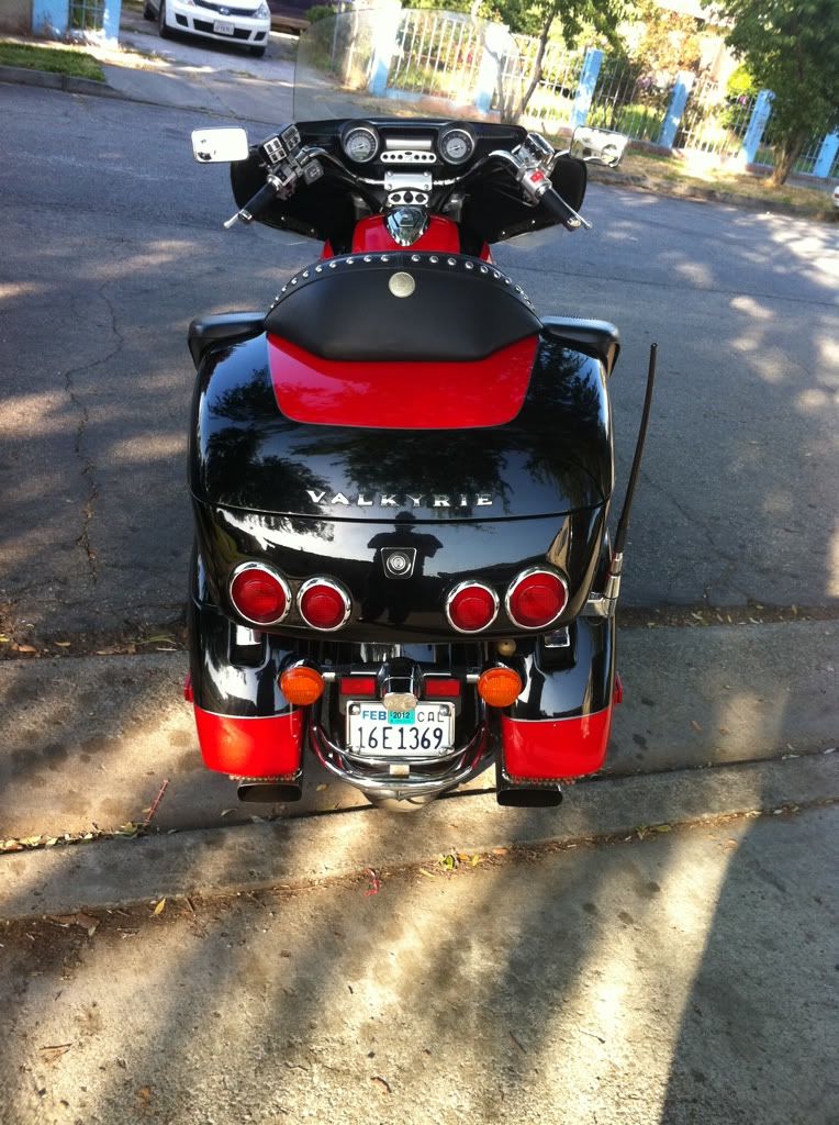

Just for a bit more fun here are some more pictures of what has been accomplished.
