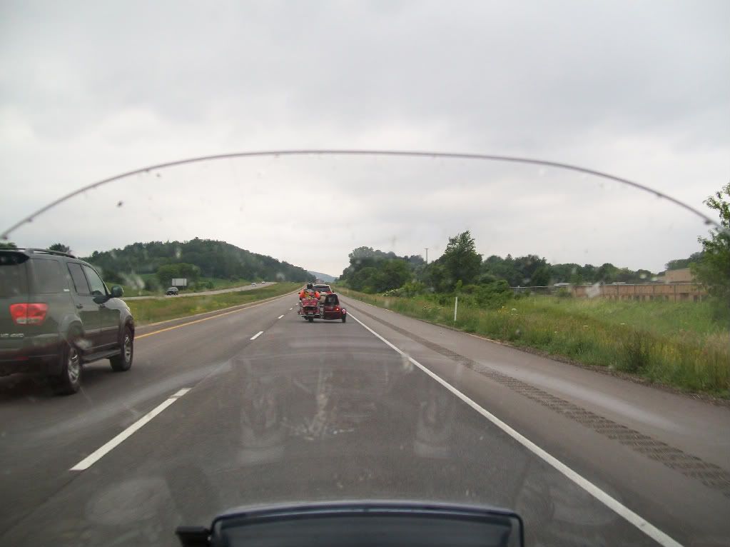

I installed a sidecar on my Valk about three years ago. It was a Motorvation Spyder, see pic.
When you add 300 pounds of weight off center, handling is completely different.  The Valk is slower on acceleration. When you accelerate the sidecar tends to pull the rig to the right, when you decelerate, the sidecar tends to push the rig to the left.  you no longer use countersteering, the rig steers like a car, you turn it.  The steering becomes heavy which can be lessened by changing the trail (triple tree modification).  If the triple tree is changed, and you take the sidecar off, the Valk will tend to be unstable (this , by the way, is the opinion of experienced sidecar installers).  There is a lot more to adjusting the rig so that it runs true,etc.  Be ready to accept a new way of driving a rig.  Lots more but that sums it up from my experience.  If you asked me "Would you do it again", the answer is no but that's me.

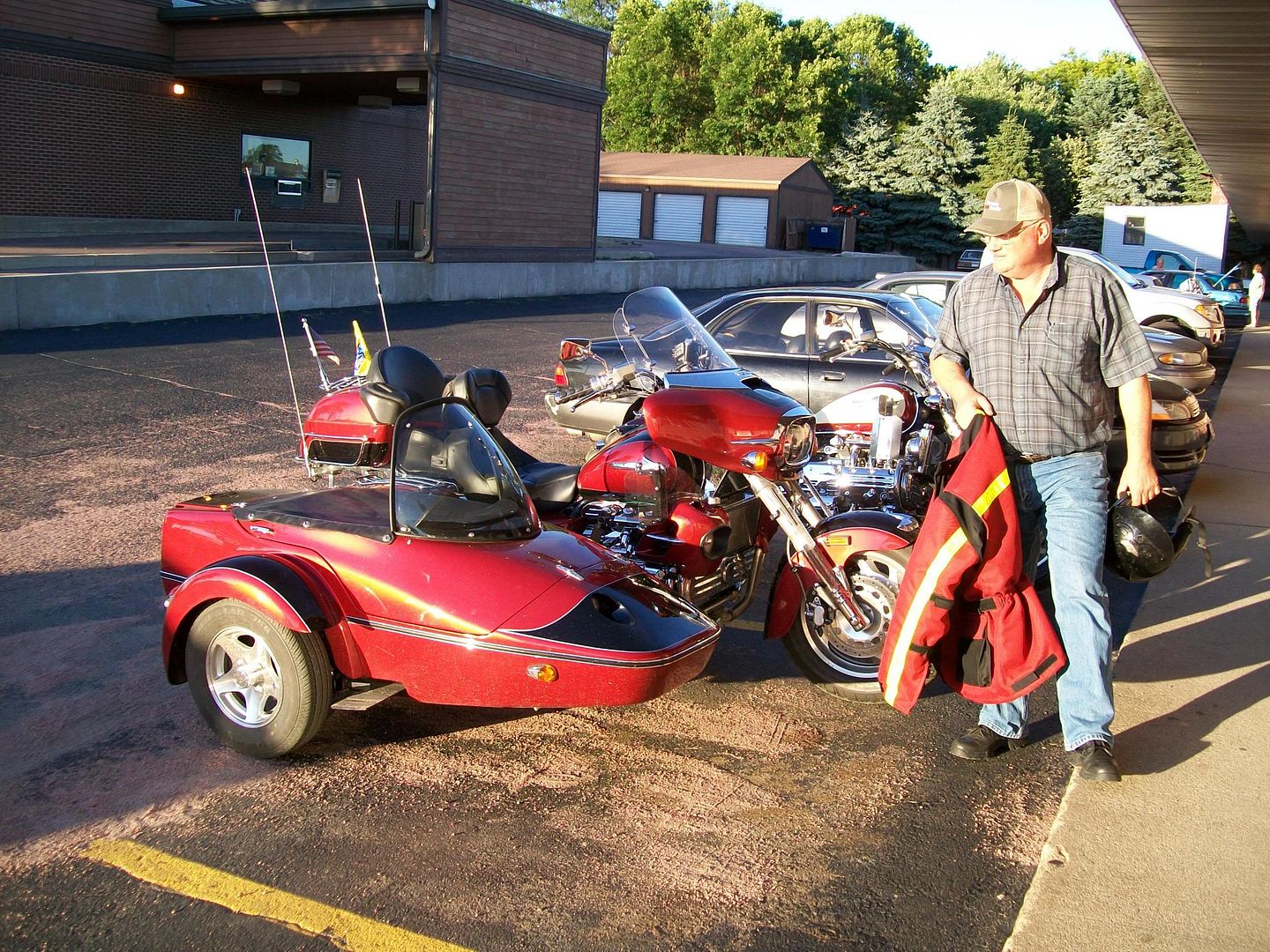

Here'a pic from Inzane in Colorado a few years back.

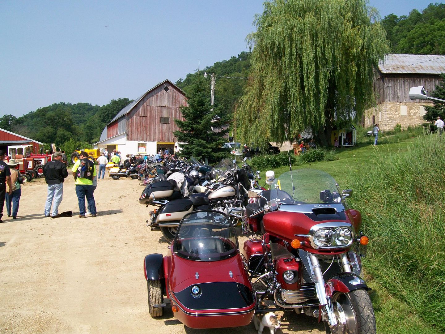

MP has one, here is a couple pics hoser

You honor me, sir, by calling me "Friend."  And that would be my I/S in the picture from Colorado.
The dogs love the sidecar.  Wizard has driven it ONCE.  He likes riding in the sidecar, but on that bike, he chooses to leave the driving to me.  It does act as if it has a mind of its own, but it's actually quite controllable.  Like any vehicle, you just have to pay attention to the quirks and adjust to them.
It feels nice and stable at speeds up to an indicated 100.  I've not had it above that but wouldn't expect anything else.
Warning:  the first time (or three) that you "fly the chair" will be very startling!  (For those who don't know, "fly the chair" is one term for having the sidecar's wheel come off the pavement.  The hardest thing to adjust to is that it flies on RIGHT turns when everyone expects it to happen on left turns instead.)
