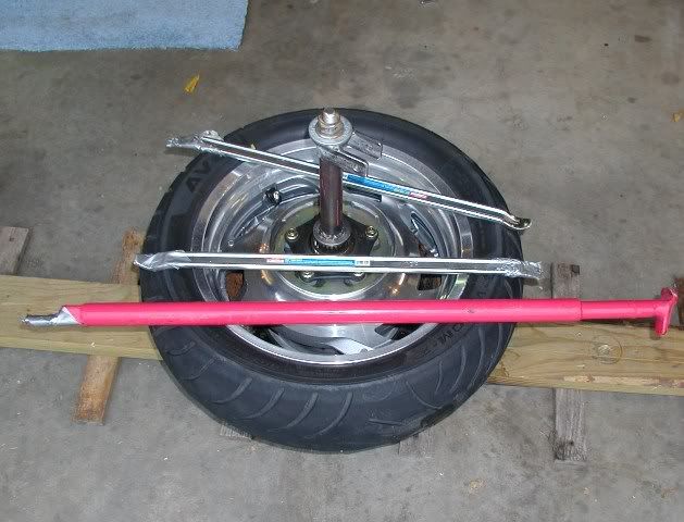

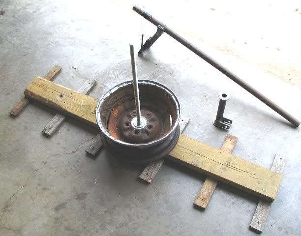

I just changed my rear tire with my home made apparatus.  I started with the idea of "jkozloski"  http://www.jkozloski.com/tires.htm  from the Shoptalk forum here.  Thank You to JKozloski!  I used a '67 14" Ford steel wheel for the base and a 3/4" all thread for the axle/fulcrum.  I like the one that you posted and may modify mine to adapt the base like that one.  As far as tire irons I used the ones in the following pics and just taped the ends w/ 3 layers of duct tape.  I used the tool from my HF car tire changer for removal but the other end for installing didn't look like it would work.  For removal i used a 2" piece of 3/8" fuel line split, soaped over the edge of the rim and under the HF tool.
Installing the tire was by hand for the back sidewall - with lots of soapy water but the front side required prying the last 6-8 inches on with the taped tire irons.
Here's some pics:
The Ford wheel bolted via the all thread to the 2x6 base.
Breaking the tire down.
The tools used
The finished apparatus
Chris

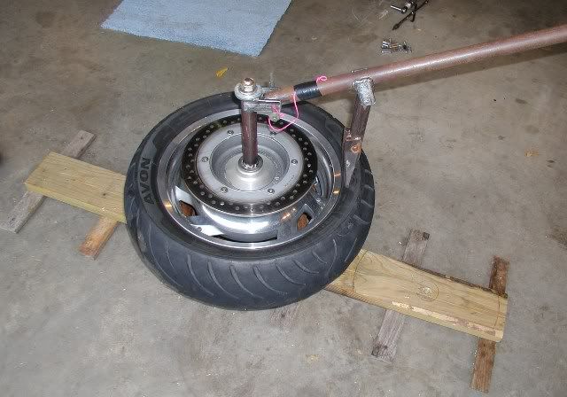

Tim graciously sent me several pictures of the changer he built - all I can say is...WOW!! A man after my own heart...
Anyway, if you are interested, I am posting pics here, that have been reduced in size. However, the originals are over 2M, but have great detail! So I am posting links to those, as well - you can go to those pics, and right-click, save as, for bigger, better pics...
Pic One:
Link to bigger pic:  http://crbest.com/valkyrie/tim04.jpg
Pic Two:
Link to bigger pic:  http://crbest.com/valkyrie/tim03.jpg
Thanks, Tim!! I'm sure you'll get a few questions, at least from me!
