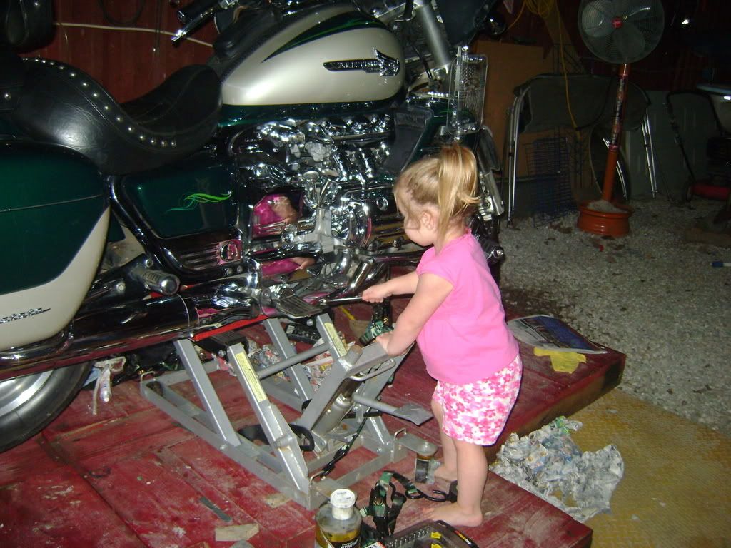

« Reply #11 on: October 26, 2010, 06:54:19 PM »
I agree a Honda service manual... priceless. Check out my thread in tech page. Adapters for auto lift. I have designed some adapters that bolt to the bike and have pictured a couple of them. I don't like the idea of balancing my bike up there especially if I'm removing wheels. I would recommend C clamping to the Sears lift similar to the way I have on my auto lift.
The Sears lift comes with straps ( mine did anyway  Undecided  ) ...I've had both my wheels off at the sametime...I have the home-made wood adapter from Shop Talk the bike is very stable when strapped down to the Sears jack.Picture below is a off-brand jack I got at Advance Auto Parts I still have it as well and never had any problems with it either...My A # 1 Valkyrie technician when she was just leaning the ropes and working on Stanley Steamers bike Smiley
