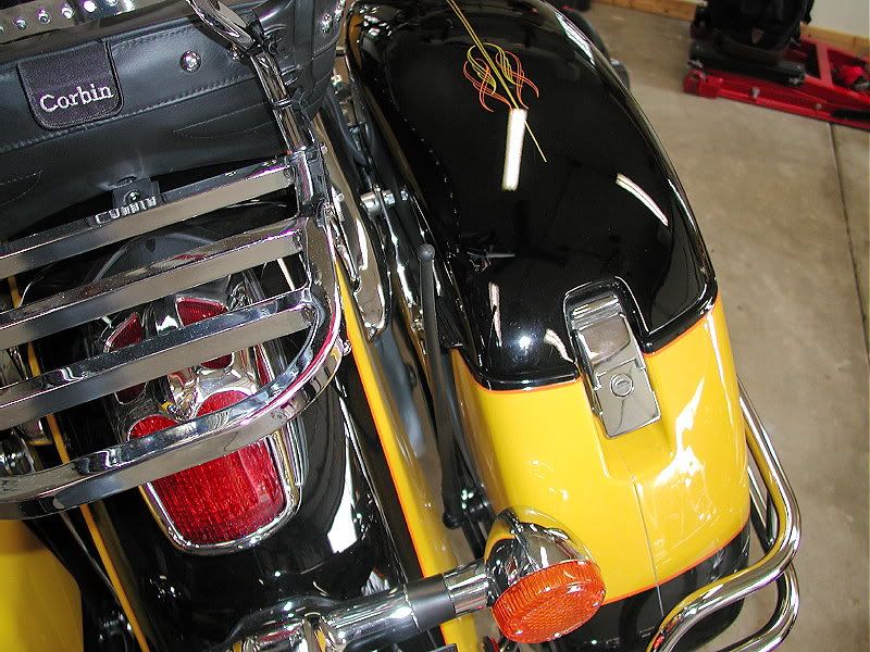

You've got the trunk off I assume.
I made a mount base that I can fasten the antenna base to; and have it all mounted down between the saddle bag and the fender. It is mounted to the chrome assembly that runs between the bags to steady up the bags.
Just went to local discount auto parts store and bought a cheapie flex antenna and tapped the antenna base itself and screwed it on!
Tapping the antenna was only slightly effective since I didn't want to destroy it in the process and the threading was at best very bad.
Screwing the antenna on to the stock base was to my mind tentative at best and I figured it would fly off eventually, but it has not and it's still there.
Reception is good, not as good as stock when it was mounted on the trunk frame but still is good.
It gets seemingly directional: Where riding away from the source reception is better compared to riding towards the source. I relate this to mounting it so low and between so much metal.
I do not think bending it and installing it in the fairing will be viable but then again it just might be.
If I were to do what you contemplate, I would simply get a tester first (like a wire) and see the results since I feel it is a difficult job you suggest.

I too have a rubber attena mounted down low inbetween bags and rear fender just behind turn signal on the left side of bike. It works ok but since I installed the XM I don't use FM much anymore.
