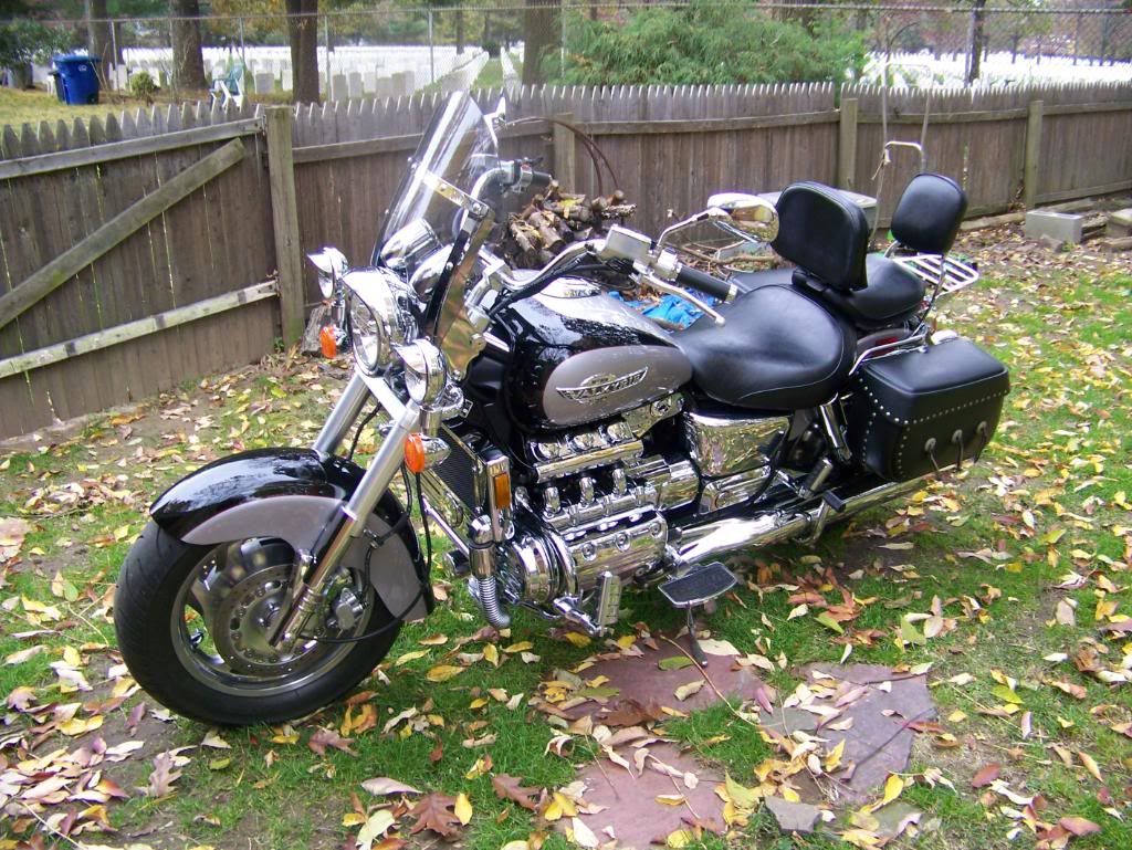

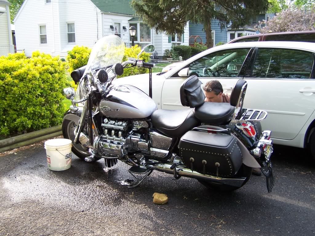

I hear ya on the carb cleaning. The Startron says the bottle will treat 128 gallons. All I know is the Valk is my 3rd bike, I have always kept them filled and with a stabilizer and would run them every week or 2 for 15-20 minutes. The Valk I bought sat with fuel unattended for 2 years. I was lucky to get it started with fresh fuel & Seafoam but I was never able to get the stumble gone from partial throttle. It felt good under wide open but flat & stumbly under light throttle. I was too intimidated by the 6 carbs and took it to the stealer. $500+ later, she runs like she should.Pic on day 1 and now.

HMT... Wow, very nice and clean.  You even have one of the rare Show Chrome radiator hose covers.
