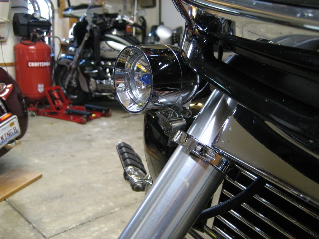

I like the PIAAs, but didn't like their mounting arrangement.  By mounting them on a caliper bolt, they're subject to stronger shocks from every little bump on the road.  Moving them up on the fork tube is much gentler on the bulb filament, and at the same time elevates the lamp so it can shine down on the road a bit, rather than "skimming" it.

« Reply #18 on: November 01, 2010, 07:56:16 AM »
I like these, which PIAA's or model are they?
Red Diamond, those are the PIAA "005"s.
FYI, they cost more than the 1100s (cause they are all chrome) but are not as bright as the 1100s by a long shot.
