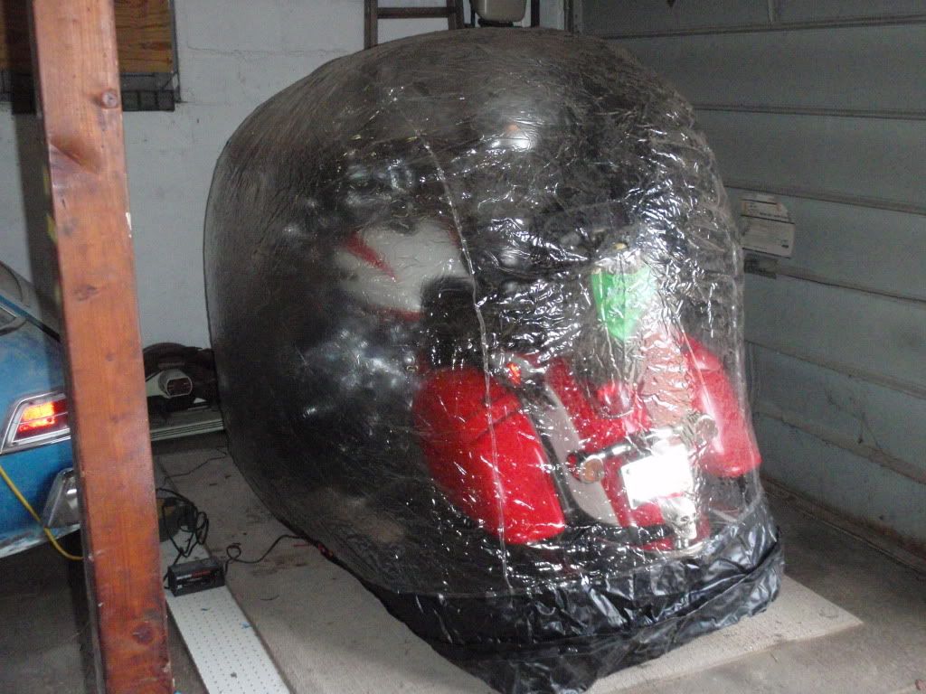

This is been some of the best money I've spent for the winter storage. Bike goes in clean, comes out just as clean. A small fan runs continusally so there is never any moisture inside. Never get any pets or pests to worry about. Added bonus if something falls against it, it just bounces off the bubble and not the bike.  cooldude I bought a 5 x 10 area rug for $45.00 that it sits on year 'round. I run the cord for the battery tender into it and then zip it up.

A Valkyrie in a snow globe.  And just in time for the Holidays too!

« Reply #4 on: November 07, 2010, 06:01:05 PM »
My neighbor wanted to put it on his lawn for chrismas.  Grin

Scoot,
Where did you get the bag you have your bike in?
That looks like a way cool idea. I am going to do some shop renovating this winter, and i'd love to keep the bike protected.

Scoot,
GS
I got it from the local harley dealer. As with everything you buy from Harley it is marked with their name all over it. You can buy them on the internet, but at double the cost. If you do go with the harley bubble you'll want to get the one for thier largest bike. This is my third year with it and I think it was some of the best money spent.
