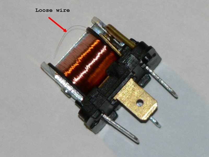

I took one look at the unsealed junk relay that comes with the stebel and bought a better unti.
Here is the guts of one of the stebel relays
Nothing like a bit of wire bouncing around free to mess up your day.
