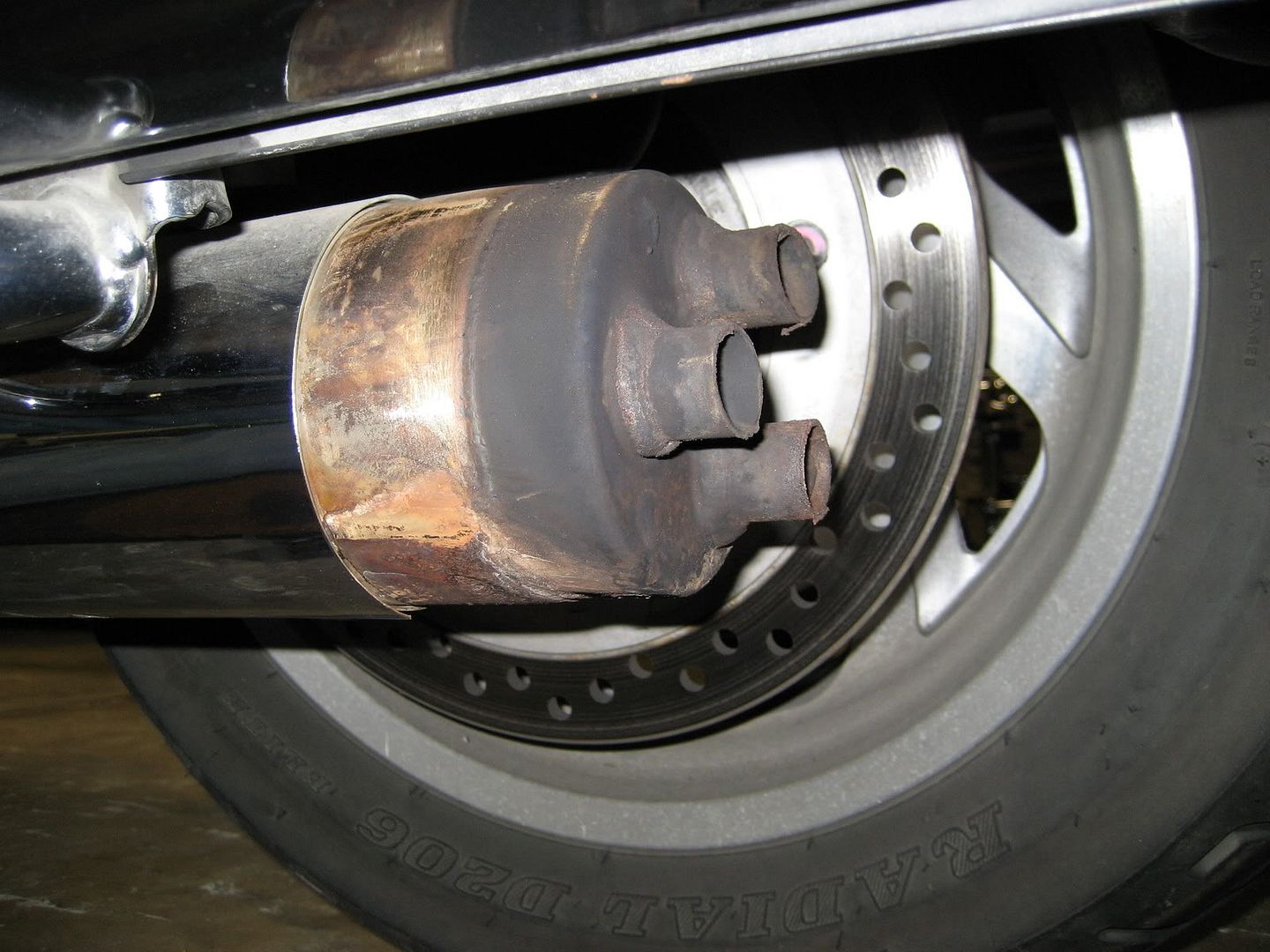

Hi All;
Thanks again for all the advice. JohnU may have hit the nail on the head, Aussies may be different in that we have a different exaust??
The exaust I have has about 1" pipe for about 1,1/2 inches out of the canister and then smaller pipes out the back.

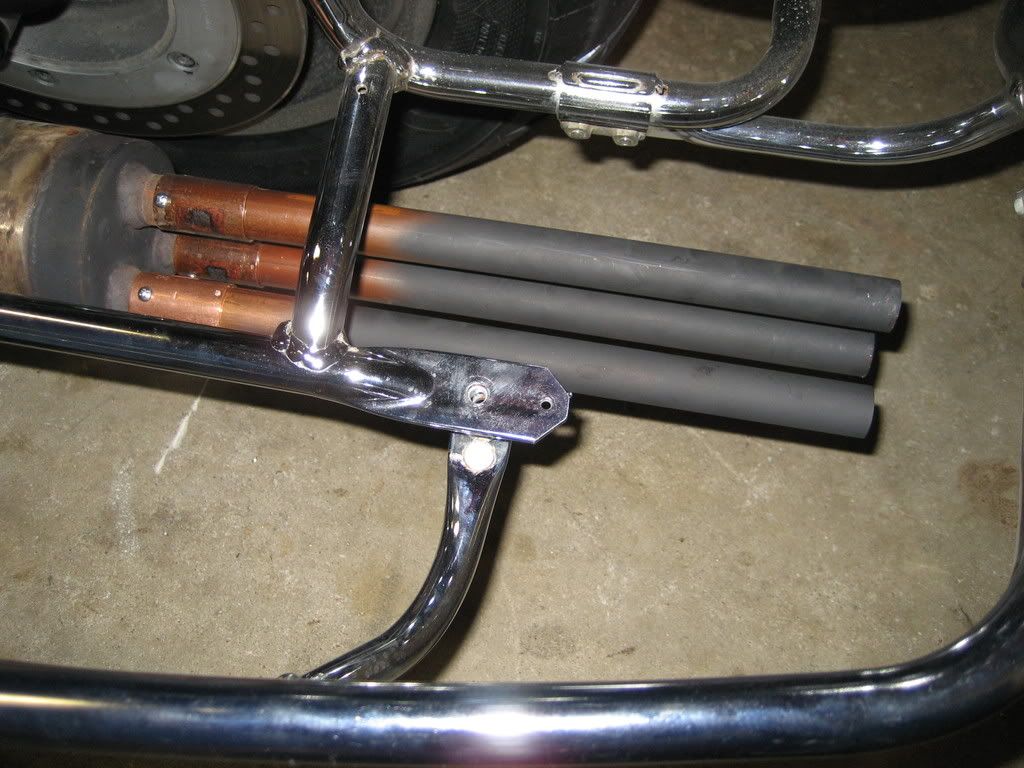

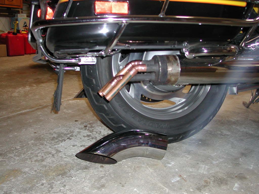

« Reply #14 on: April 04, 2009, 09:22:50 AM »
Kingbee,
Have you restored your piggies with the copper fittings shown in the photo?Can you get away with "soft" solder on the joints?
I don't remember what mine used to sound like but was hoping that restoring them would do away with that "ear buzz".

« Reply #15 on: April 04, 2009, 10:53:16 AM »
I used stainless self-tapping screws on each connection, 90 degrees apart, for a solid install and to eliminate any wiggle. This repair would be almost impossible to do with OEM tips, as alignment would be a son-of-a-gun.  crazy2

Thanks Grandude,  cooldude Ill have to do it from home my work Nanny will not let me enter that site. tickedoff
My piggies were 1/2" diameter, welded into pipes about 3/4" diameter which were then welded into the cannister. The photos will make this more clear when I post them, but I think Australia Guv :uglystupid2:mental have again required smaller pipes to go with the smaller jets. Cry

« Reply #25 on: April 06, 2009, 09:04:10 PM »
Delete my earlier post. Yep, in Aus they're stepped down as per your pic. You're lucky though Woody as mine look like they were butchered at the factory. In some cases on mine the large piggy pipe only consisted of about 1/2 inch being left at the back of the canister with two smaller diameter pipes placed into it. I cut mine off leaving only that 1/2 inch piece of large pipe, but wonder now, should I drill out the smaller pipes that are left inside the remainder of the larger ones. I don't know how far into the canister the smaller pipes might protrude, and I don't want anything rattling around in there if I attemp to drill them out. Hmmm, a quandry.

« Reply #27 on: April 07, 2009, 10:20:04 PM »
Hi Guys;
Again with the pictures.
This is what the piggies look like down under.
