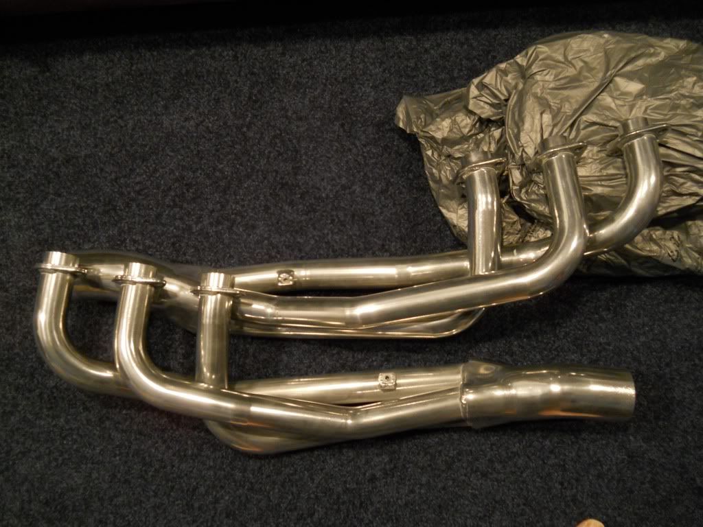

 Here is a pict of my headers redone by Jet Hot

Looks great. How much did it cost ?

Looks just like the ones I had did a few years ago on the Chevy Trike.
It lasted for about 12 years.    Another pair of headers I bought and did NOT treat rusted through in less than 5 years, but, I got to give consideration to the miles on them also.     Close to 80,000, and 1 trip to Alaska and back..

  Cost was 295 and I paid to ship them to South Carolina.
 They pay to ship them back. The headers came back
quite a bit better that I thought they would.
   Jet Hot uses a media baster that will not hurt the
 metal. Then the coating flows into the cravases to
smooth them out as well as it can.
  They also do the inside of the pipes to stop rust from forming
from the inside. The coating is supposed to be good to 1700 DEG.
  It,s called Extream Sterling good to 1700 Deg.

They don't look like OEM.

  They are Viking headers,larger pipes to collecter.
 More power! That is why some of us are hoping for
 another run of these pipes. Greatest thing about them is removeing the mufflers
 working on the rear end.
