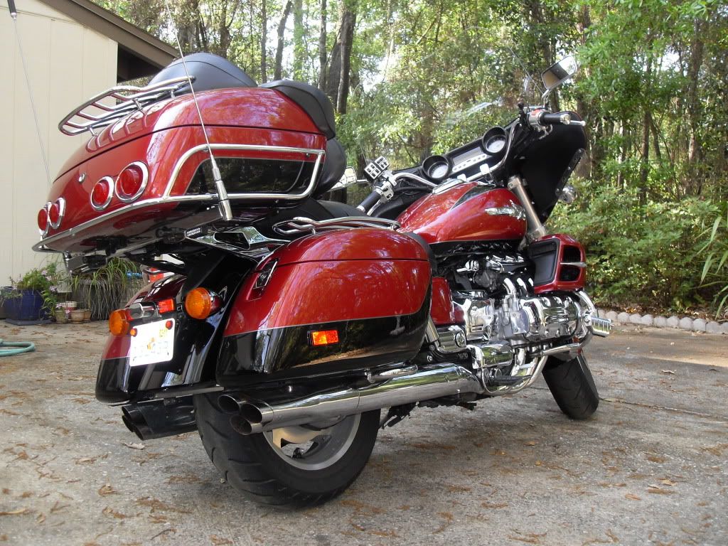

Since I'm on a roll with basic questions - allow me to ask another.
When I took off my pipes, I did not notice any gaskets for a single exhaust port.  It appears as though my gasket is connected across all three header pipes.
I suppose it is possible that all three gaskets stayed with the bike and did not come off on the pipe - but I seriously doubt I am that lucky.
I'm just asking because my "gasket" looks nothing like the ones for sale on the z1 site or HDL.  As a matter of fact, I cannot even find my "gasket" on the HDL parts fiche.
So - is this one-piece-across-all-three-pipes-thingy my "exhaust gasket", or am I just confusing it with something else?

Do you see the one-piece-across-all-three-pipes-thingy in this picture? It's not the gasket...
The first time I took my pipes off, I found my OEM gaskets mashed up in here so flat that at first I didn't think they were there. After I realized what was going
on I encouraged them out with a screwdriver and put new Honda ones in. You can see the dab of high-temp silicone I put up there to keep the gaskets in
during installation... others use grease, or or squeeze them a bit out-of-round...

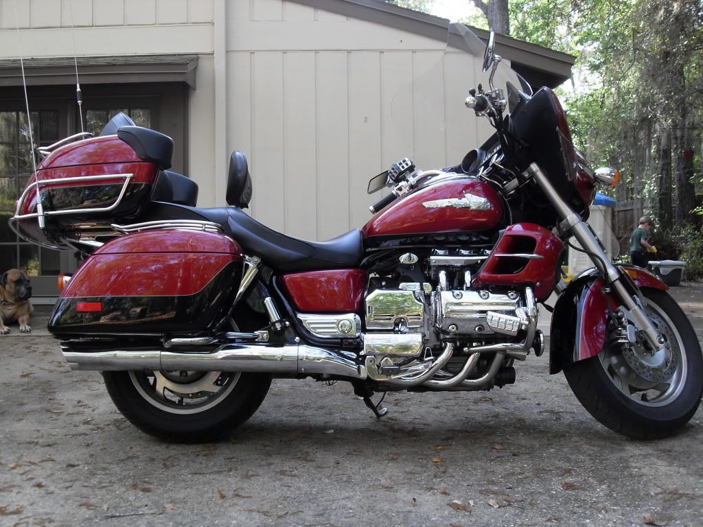

What brand pipes and we need a pic.
Brand - I couldn't tell ya.  I've only had the bike about a year, and still have way too much to learn about these Valks to answer that question.
Can you tell what kind of pipes they are from these pics?  If not, I'll see what I can do about getting some better ones this weekend.
Kaiser

« Reply #26 on: December 20, 2010, 06:56:00 AM »
Wow...this is really embarrassing.  Embarrassed
Normally I would not expose my idiocy and just keep quite so that nobody is the wiser that I do not know what I am talking about.  However, in this case, hopefully someone else on this board can benefit from me being a dumb a$$.
I've got the same setup as everybody else.  The part that I was thinking about is exactly what Mike posted earlier (in the picture of his pipes with them pointed down).
Guess that's what I get for putting my exhaust back on at 2:00 AM and then posting about it from memory.  uglystupid2
The good news is that now I do not have to ask what a leaking gasket sounds like.
Sorry to waste everybody's time.  I'll go back to lurking the shadows and reading more than I write.
