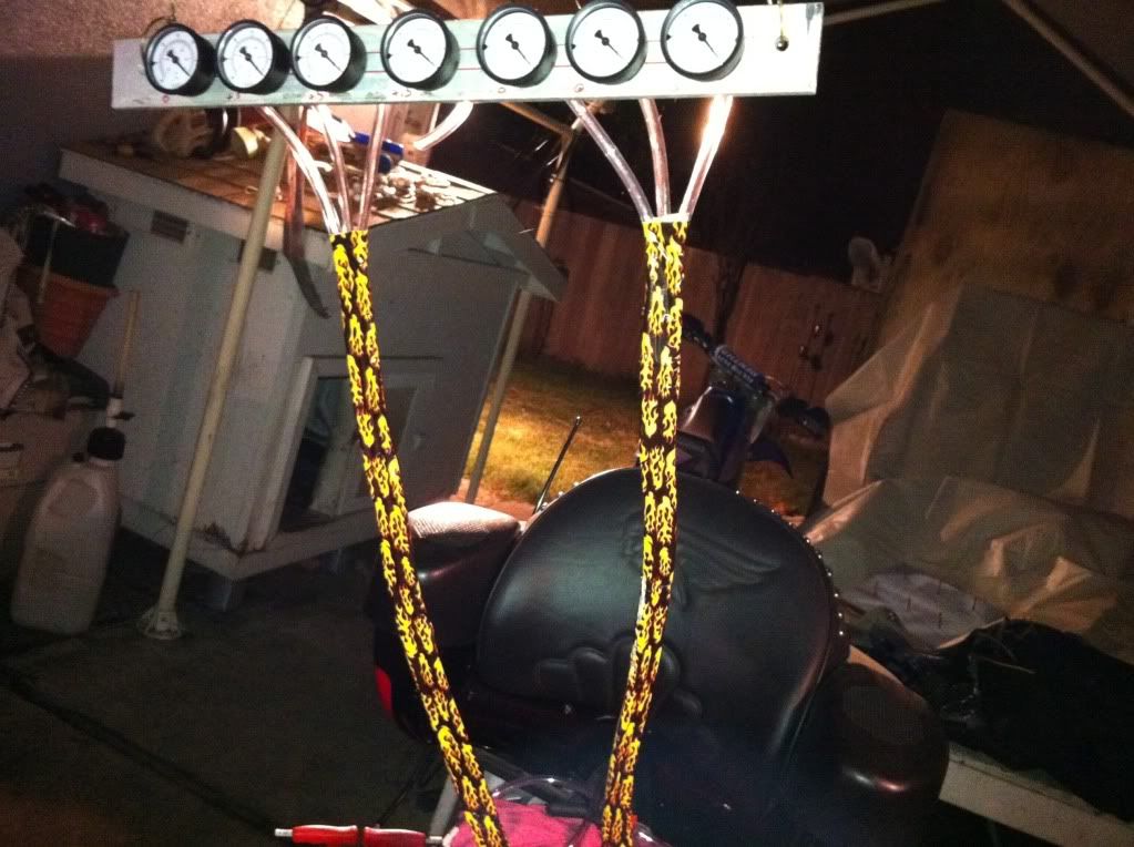

« Reply #30 on: December 21, 2010, 12:27:19 AM »
Here is what I came up with using Ricky-D gauge setup as my model. I decided to buy 1 extra gauge just incase I got a bad one.
I think mine cost less than $45-50 and that included the Cool flame duct tape, got the gauges off of eBay check out Ricky's link for the gauges and I used 1/4" vinyl tubing from hardware store and vaccum line from auto store then a plastic 1/4" - 5/32" vaccum adpaters to about a foot of 5/32" vaccum line..    I later after synch I ganged all my vaccum ports like Dag had done and it did seem to even further the vaccum pulses I will add a one way check valve that will then feed my audiovox cruise control. To do the gang setup i got a few brass "T" fittings from fish store and an automotive vaccum cap on third leg of the Brass "T".
I still need to add easier to user regulater or snubbed to slow down gauges reaction (needle bounce) from vaccum pulses.
« Last Edit: December 21, 2010, 12:45:24 AM by fordmano » Logged

« Reply #31 on: December 21, 2010, 12:32:21 AM »
You can check my Multi point upgrade thread for a bit better pictures but incase you don't wanna look there here is a slightly closer picture if my gauge setup,
