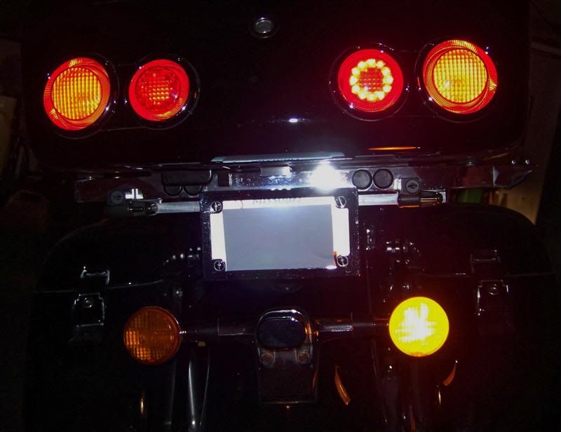

« Reply #2 on: January 03, 2011, 07:37:40 AM »
          Citydriver , I added turn signals to my trunk running light housings. Mark T and many of the folks here have a lot more knowledge in the electrical dept, than I do. So while my method was twice the cost I felt more comfortable with it. I purchased a kit from the electrical connection http://www.electricalconnection.com/other-lighting/tsk-star&sport.htm I opened the trunk lighting housings and mounted the light rings from the kit in the running light lens ,drilled maybe a 1/16 hole in the back of the running light housing to run the wiring out for the LED light rings from the kit  (sealed the hole after completing the install) ran the wires from both left and right light rings through the wire loom with all the trunk wiring, down the frame until I reached a point just to the drivers rt. and aft of the battery ,at this point you can splice into the signal wiring . I have had mine installed since 06 and they have worked fine. I left all other wiring alone , didn't try to make them brake lights, running lights or any thing else. Here it is with the rt. signal on. Hope this helps you.
                               If I were to do it again I might try using one of these.
                       http://www.customdynamics.com/honda_turn_signal_led.htm
