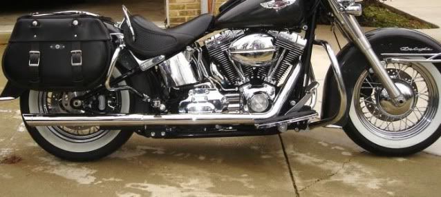

Has anyone you know of looked into using any of the Harley Davidson FL guards ??  I'm guessing there would be some modifications required. Looking at some of the stuff on e-bay it looks doable. End result of course would need to look "store bought".
Check it out ....
http://cgi.ebay.com/ebaymotors/NEW-Harley-Davidson-Softail-Rear-Saddle-Bag-Guards-_W0QQcmdZViewItemQQhashZitem27b7e541d7QQitemZ170588979671QQptZMotorcyclesQ5fPartsQ5fAccessories

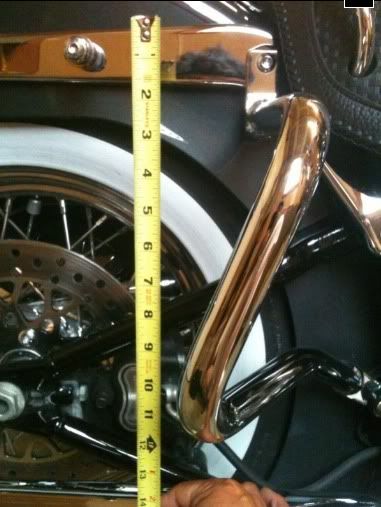

I notice you are using those bars AND risers. I have the same risers and would like a little more back and width, looks like the perfect setup! Can you install those bars and the risers with the stock cables? Thanks for the photo's and the link cooldude

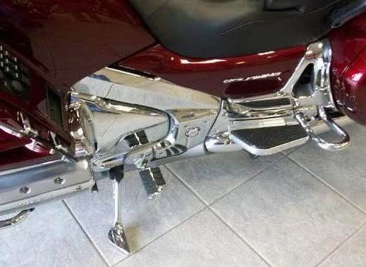

I'm going to give these a try. Off an 1800 GW. Should be a pretty easy mount with some mods. They are take offs from a trike shop. Make for a nice little winter project.

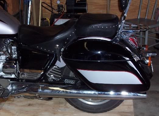

Saddlebags are Tsukayu's so no OEM rails/guards .... Looking at what I've got to work with for mounting and rigidity they would need to mount basically right under the rear footrests or slightly rearward. I have three days to decide to return and get my $50 back.  If I can I'll bolt it up with one bolt and take a snapshot.

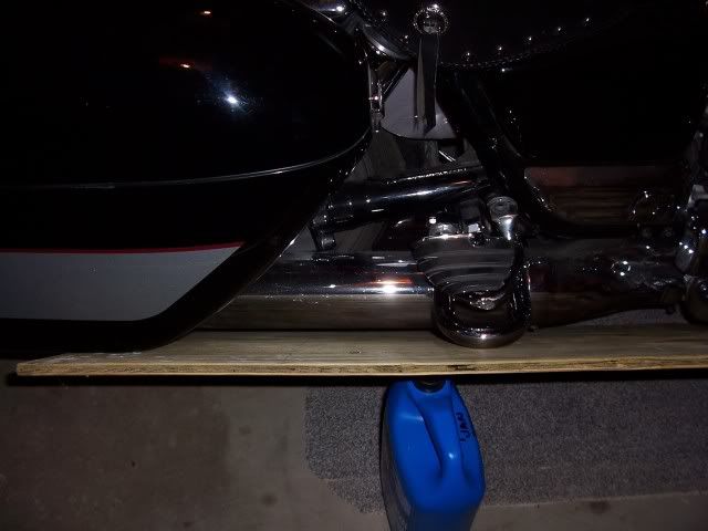

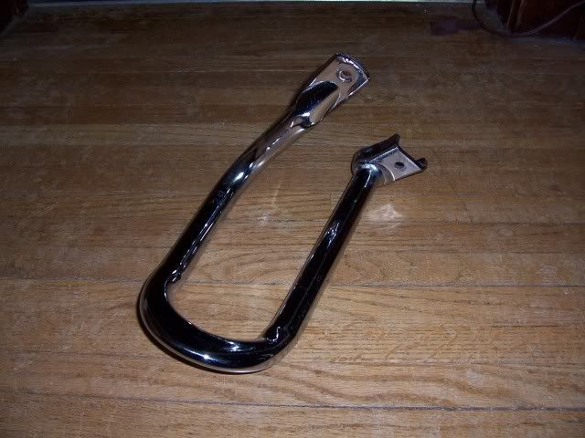

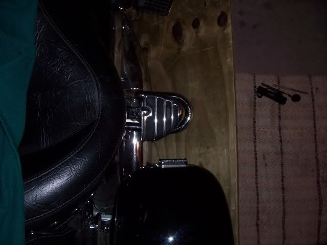

Finally got some photo's to share. I set them up against the rear footrest mounting plate which also acts as the muffler hanger.  It doesn't look like it's going to pan out .... I don't think they're long enough. I set a piece of plywood up against bottom of rear tire to see what touches first. The guards and saddle bags touch pretty much the same time. They might prevent a tip over but it's pretty obvious from the pictures that they would not provide any protection if the bike was laying on it's side.
Also, They would pretty much have to be mounted in the location I have them. Any further towards the rear and they wouldn't have much if any backing support.
It's too bad cause they are like brand new.  What's your opinion ??

Hmmm....Maybe add a spacer to bring them out? Not sure. I think when my bike lays over there is a minimal amount of space between the ground and saddle bag. I do have a few scratches on the bottom of the bag from a tip over. Maybe lay bike over then place the bag on its mounts and see.
Maybe leave the bolt you have mounted and swing the guard towards the back and add a steel plate to mount it to. It would be back closer to the bag.
Warlock
Posts: 1296
Magnolia, Ms
« Reply #19 on: January 20, 2011, 06:51:07 PM »
That's what I was thinking. Maybe some chrome sockets with longer bolts. I used some chrome sockets once to make some risers for a VTX  Grin

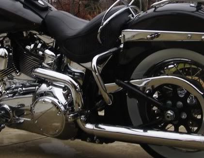

I see a lot of HD's stranded alongside the road here...nah, THAT'S not nice!!
Try this - I have quite a few friends with HD's. I like the looks of the bars a lot, and I've thought about measuring all I see, when the weather changes, to see if I can come close to matching something up. Of course, with MY luck, the best fit will be off a '58!! I'm leaning towards making sure the top fits, the length is fairly close, then making a stainless steel "whatever I need" to mount the bottom, and polish the heck out of it. I've done quite a few stainless mounts/brackets/etc. in the past, and they can be quite nice. Where there's a will, there's a way...

I'd be REAL appreciative if you'd share the results of your search. I did a little search on my own on the web and found these .... They are for a Softail Deluxe.
Thing is, there are lot of them on ebay like new for fairly cheap. If you do have a mishap it would be a lot easier to replace than Valkyrie OEM.

More than happy to! I want a set badly enough, I WILL figure out something. I plan to take a bunch of measurements of the Valk, and maybe even mock-up something to carry with me. Hopefully, as you mentioned, it will be something readily available, and easily modified. But regardless, I'll have a set, somehow, someway! I have my Valk just about how I want it - have my trailer hitch, bags, and rails. The only other thing I'd REALLY like to get, is the rail around the seat, when you set it up solo - I already have the rear fender rack (yeah, I'M the one who pay the gazillion bucks!), so there are really only a couple things left I plan to get. And guards for the front of the bags, is top of the list.

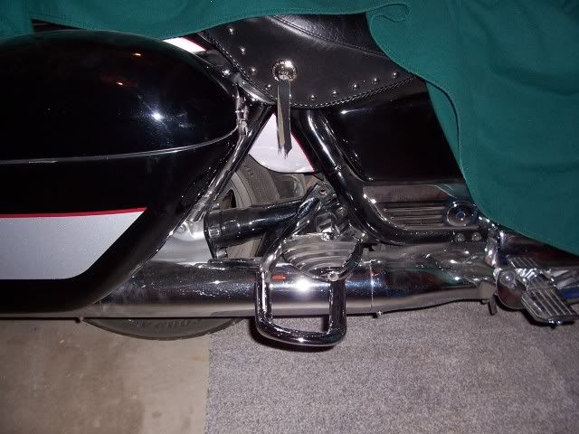

Brought back the 1800 guards to the trike shop to get a refund and they happened to have some take off's from a 1500 GW (like new) out back.  Brought those home and sit them on the bike and looks like they just might work without too much modification. They are long enough and fit in more with the lines of the frame. Have 30 days to decide to keep them. These should be pretty easy to acquire with 13 years of the 1500 Goldwings !!

One thing I forgot to mention in why I'm leaning towards the GW guards (at least with Tsukayu bags) is that with the vertical type saddlebag guards you might get some complaints from the passenger with inadequate legroom. I'm already hearing from the wifey that the back of her leg is rubbing on the hinge of the saddlebags .... by adding a vertical type of guard would only elevate the complaint factor if you know what I mean.
