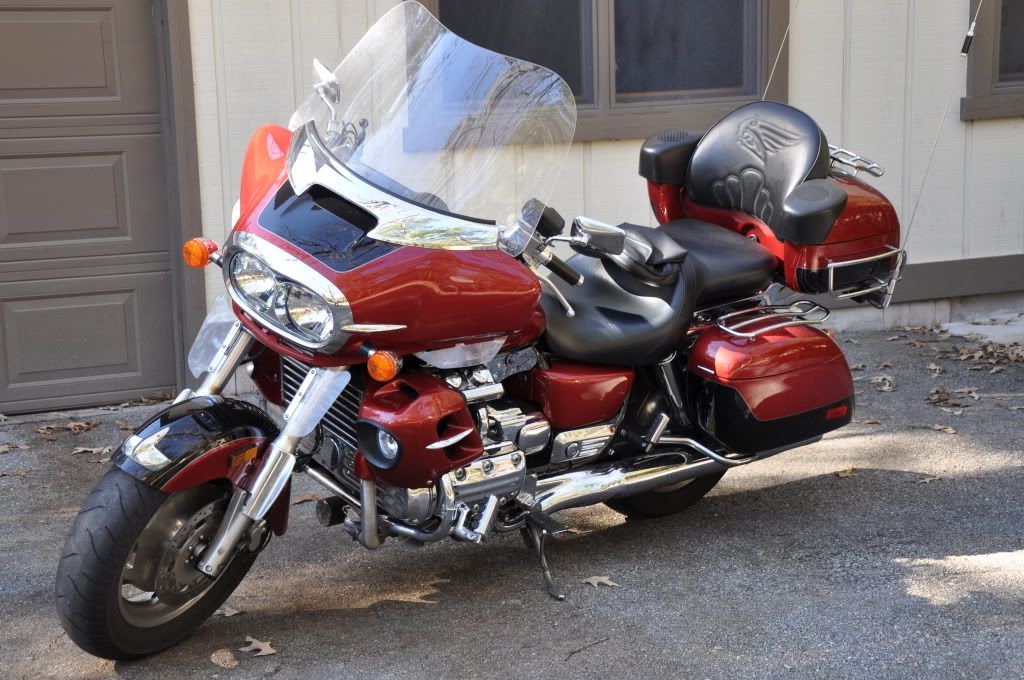

That's cause you got the best color out there!
Likewise.  I just took this pic a few days ago.  (Proud-of-my-bike-pic in 3, 2, 1...)
