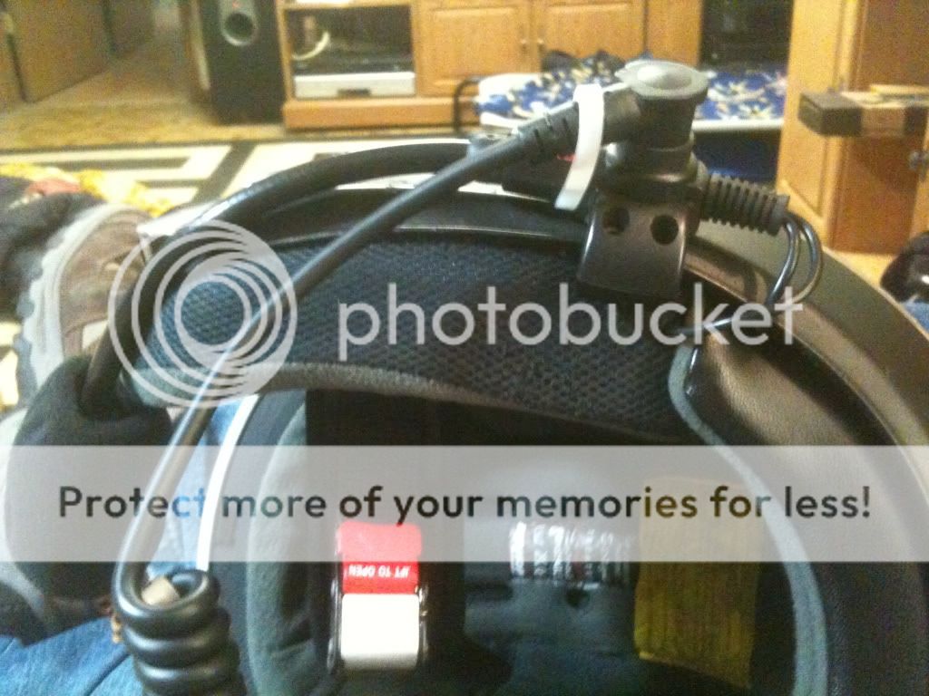

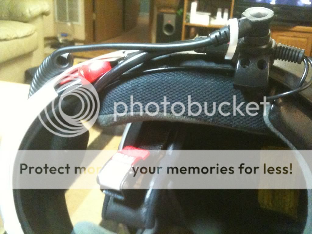

Here are some pics I just took.  The boys have a lot more room in the helmet than I do... Shocked  It was a tight fit to put the mic inside the chin bar.  I would say that you could have the mike under your chin and still be heard.  Might have to turn the intercom volume up a little more.  It really does work better on them.  Cheesy  How this helps.
Joe

Thaht's the same thing in did with my wife's modular. I did use the smallest windsock J&M has, and it all works fine. I can still hear her telling me what to do. But then I don't think I need the intercom system for that  Grin

Thanks Joe. Once again you guys go above and beyond. Awesome pics. That's exactly what I concluded at the bike shop today. I am going to try it without the windsock. I don't think I could handle that jammed in there very long. If there is too much wind noise I'll have to figure out something else. Maybe I could find just a smaller mic and swap them out. Probably just two wires in the boom to splice.  After trying a few helmets today I'm fairly set on getting the IS-Max. Thanks again.
