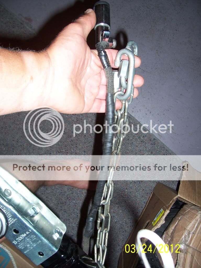

OK, the install went great, except as you will see, the pigtail is now too short.  UG!  Well nothing a little wire,solder, heat shrink and tape wont fix.  I like it, well made product.

Ok, I cut the pigtail, added 7" of wire color by color heat shrinked it taped it with high voltage tape....my wifes son calls it peckerhead tape......LOL  it worked great, and all the lights still work, AMAZING!
