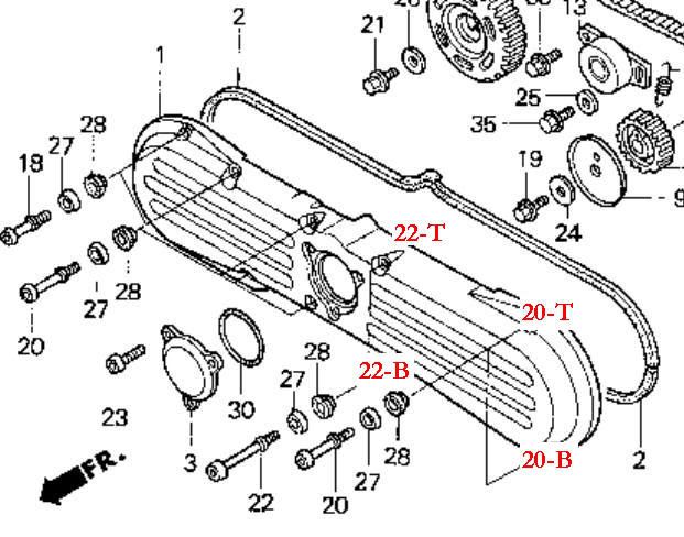

STANLEYSTEAMER....THE BOLT YOU ARE TALKINF ABOUT IS #20 IN SODBUSTER'S PICTURE.  WHEN YOU PUT IT ALL BACK TOGETHER, PUT A SMALL DAB OF RTV SEALANT ON THE TIP OF THE BOLT BEFORE YOU SCREW IT BACK IN TO RESEAL IT .  DO NOT GO CRAZY TIGHTENING THE BOLTS BACK DOWN, THEY DON'T HAVE TO BE GORILLA TIGHT.  GOOD LUCK.
I gotta ask as one of these days that will be a job I will need to do.  You say #20....upper or lower?  And in the picture they appear to be shoulder bolts similar to the bolts holding the valve covers.  Is this correct?  That would explain the comment about not over tightening.
States I Have Ridden In
ricoman
Posts: 1888
Sarasota, FL
« Reply #14 on: March 27, 2011, 11:57:35 PM »
I believe the bolt is the second one from the right, on the top, in the pick-#22.
The #20 bolts are on the outside right in the pic and are shorter.

THE BOLT IS NUMBER 20 ON THE TOP.
ricoman
Posts: 1888
Sarasota, FL
« Reply #16 on: March 28, 2011, 02:13:34 AM »
nope, it's the second bolt from the right in the pic   #22
run out to garage and look at your Valk.
10 bolts total, 2-#22;2-#18; 6-#20
#22-6mmX47mm;18-6mmX17mm' #20-6mmX23mm

So .... which one is it ??
VRCC # 30938
ricoman
Posts: 1888
Sarasota, FL
« Reply #18 on: March 28, 2011, 04:31:49 AM »
22T (the Top one)
