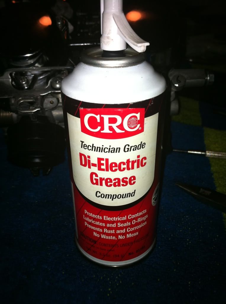

She breaths fire once again,,, first off NO I do not know for sure exactly what was wrong but it seems mostly fixed now.
There was only one thing that I ran across that really seemed that it would be a culprit and that is the 1 Pilot screw that was set out at around 4 turns,,, Well I only thought to check this on the very last carb I dis-assembled (dumb on me) anyway I don’t know how I had this one so far out and I also don’t know if maybe there were others adjusted incorrectly. I also am not sure if maybe I had a air leak at the rubber boots between multiple carb throats and air box bottom, also I had 1 intake O-Ring that looked funny when I pulled it out of the groove. The only thing that was specifically done differently was I used silicone Dielectric grease to hold ALL the O-Rings in place and help seal them. It even said the Dielectric grease was and O-Ring sealer, look for yourself.
Look closely it does say it "SEALS O-RINGS"....
Now here is the full rack re-assembled and cleaned and even lubed up on all parts that contact any rubber surfaces carb throat and exit I also picked up all new rubber boots that sit between carb and intake runners, there were some that did look like they had been squeezed funny on the inside.
And here is the video from the first fire up I had a little problem with the Dan-Mark fuel valve. I just could not get fuel to the bowls even opened the drains to verify if ANY fuel was getting to the carbs. Nope no fuel ok stick my ear down close nope no click of the Dan-mark valve opening when key is turned on.  Verify I have 12v+ at the supply from aux panel, yes full voltage, ok use a needle to puncture the wire close to the valve and yep 12v+ there also so lets check the ground side,,,,,,,, OH HELL, I found that I had originally used the same screw that holds the forward coil to the frame and this time it had slipped behind the frame and I missed it. So I attach the ground wire and hit key switch Yahooooo the valve clicks open and closed now with the key. Pulled the temporary fuel line and put the Dan-mark pack inline and installed the fuel tank opened petcock and turn key switch on and gave it  a second hit the starter button, COOL she fires up little rough idle and a fare amount of bluish smoke from both sides. But it will run now at any RPM.

Glad you got it going right.
I need to look for a can of the Di-electric. Is it a bottle or a tube?
fordmano
Posts: 1457
San Jose, CA.
« Reply #56 on: April 29, 2011, 09:00:22 PM »
Thanks to all that offered suggestions advice directions and especially thank you to Gordon V. who actually offered to send me a few spare parts to test with.
Gordon, Thank you so much for your extra effort in trying to assist a fellow VRCC brother. cooldude
You are most Welcome!
It was just a shame that I wasn't closer and just able to lend you the whole carb assembly. I'm most likely going to overhaul the whole thing, and place it in Chrio storage for future use.
The Die-electric grease I used came from my local Kragens/Oreily's auto parts store.
Sory I don't have a better picture of the can , but it is a small can like we see WD-40 in and it came with a handy little screw on tube with a trigger. I ended up with LOTS of that Die-electric grease all over my hands..
I found a link to exactly what I used just for clarification, thought you (and others) might want to see exactly what it looked like to help make locating it a bit easier.
http://www.oreillyauto.com/site/c/detail/CRC0/05105.oap?pt=N0941&ppt=C0139
