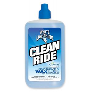

« Reply #9 on: April 04, 2011, 08:41:43 PM »
Works well for cable lube.
