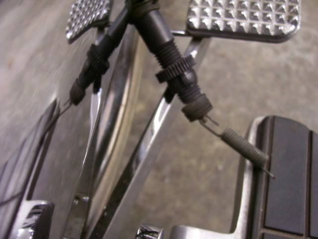

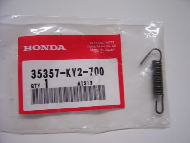

Found  that I didn't have brake lights with the rear brakes. Turns out it was just the spring that pulls the switch. The hook on the bottom corroded and broke off.  Local dealer had it in stock. $4 and change. Not hard to change but very important!!

Yea. I was tempted to rig it with an off the shelf spring or something. But for $4 it will work as designed. A paper clip will get you home I guess. I can't see how it would work correctly tho. Once the switch gets to the end of it's travel it would be limiting the brake function or trying to pull the switch apart. If you adjust it so it has some slack then the light doesn't come on till full brake pedal travel. That's just too late for me. I want it on as soon as I hit the pedal to give the cages full warning.
