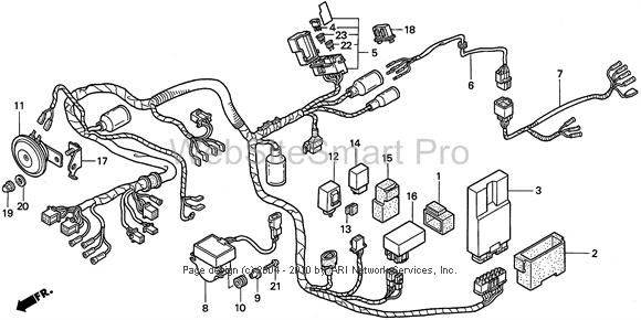

I did a search and found this post from RP#62. It was the cause of my problem.
The '97-'99 models have an Engine Coolant Temp Indicator Unit between the sensor and the light. On the later models, the sensor was replaced with a thermostatic switch that turns the light on directly. If you've replaced everything else and you still have the problem, barring any wiring or connector problems, its probably the Temp Indicator Unit. Some folks have just got the new sensor (switch) and wired around the Temp Indicator Unit as was done on the later models.
Its listed as 38710-MZ0-003
INDICATOR UNIT, TEMPERATURE (Honda Code 5051974)
#16 in the diagram
#16 in the diagram

Behind the left side cover. Remove the coolant bottle and you will see it. Release the locking tab and it will unplug. Plug in new Temp. Indicator Unit, replace the coolant bottle and you are done. I promise you, if I can do it anyone can.     cooldude
