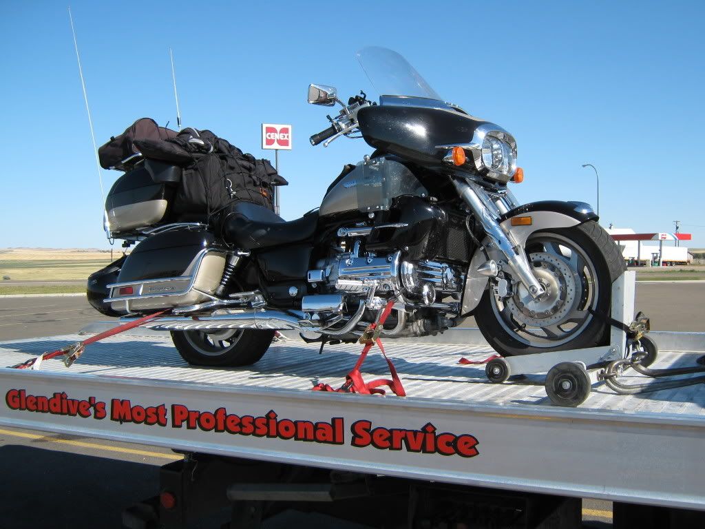

« Reply #6 on: April 19, 2011, 08:16:41 PM »
Stanley "Steamer"
"Ride Hard or Stay Home"
BamaDrifter64
Posts: 1020
Athens, Alabama
« Reply #7 on: April 20, 2011, 12:41:59 AM »
I've hauled my two I/S the way Stanley shows many a time without any mishaps...I think a wheelchock is definitely needed when you're hauling any heavy bike.   cooldude
