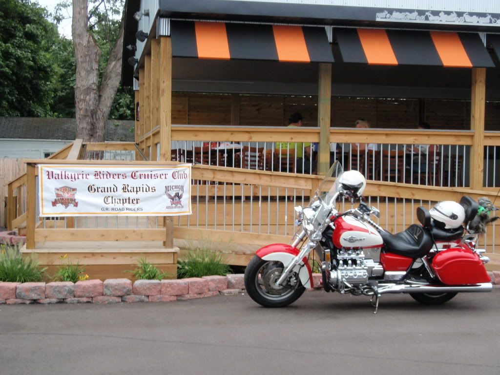

when I mounted mine I used a piece of 3" masking tape, lined it up on the edge. I then just used a marker and marked the holes. I then transferred the tape to the AirFlo tips and drilled out the marks.
Keep in mind there is a right and left side. They are not the same.
I think they lined up nicely  cooldude
