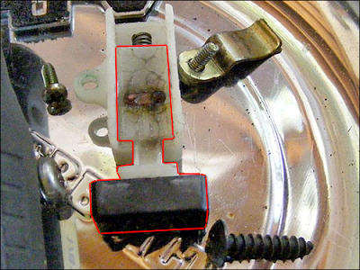

I did that recently with mine. It was hard to start. I wound up push starting it several times.
I took the switch apart and was unsurprised to fine the contacts corroded. I cleaned them up and went over them lightly with fine sandpaper to get everything shiny. I put the plastic switch back together and tested it. It worked fine. I took it apart again and filled it with dielectric grease. I checked it again before putting every thing back in the housing and on the bars. Seemed to be fine.
After getting it all together, I noticed that I again had to try the starter button a couple of times before it would turn over. This eventually got better and usually starts on first press. I assumed that the non-conducting grease was blocking the contacts and that with continued use I was pushing it out of the way.
Then the headlight started to not come back on. If I fiddle with the starter button, pushing it down a few times, the light will come back on. Even this got better with use, and I again assumed I was pushing the grease out of the way of the contacts. We got some weather and rain here (Hallelujah) so the bike sat for a couple of days. I went out to start it this morning, and again had to hit the start button 4 times before it turned over. I also had to fiddle with the button for a minute or so before the headlight came back on.
Did I put the grease in the correct place? (Inside the plastic switch, actually on the contacts.)

« Reply #4 on: June 23, 2011, 08:28:18 AM »
u don't want to cover the contact area just encase the surrounding area, to keep out water/dirt/humidity to help reduce corrosion.
yrs ago there actually was a bulb grease sold in the auto parts store that actually did conduct electricity, now its all dielectric grease. A search online will bring up the conducting type.

Sometimes the double contact "foot" thing gets depressed into the plastic slide.  If its not springing up and down when you press on it, that could be why its intermittent

The contacts are springy too...did you free them up? Often when corroded they are also stuck tight to the plastic and don't move up/down.
The grease should not be an issue.
No I didn't. In fact, I'm pretty sure they were pretty static when I had every thing apart. Sounds like I need to pull it apart again and free them up. That makes sense as to why I have to push down on the button levering the back end up toward the contact plate. Sounds like a quick, easy fix.

I had to replace my switch. The PO had install highway lights with no relay. The switch got so hot that the contacts melted right into the plastic slide. I couldn't budge them without destroying the contacts.
I installed relays on the highway lights as well as the headlight. As a failsafe I carry a piece of heavy copper wire to jump the contacts on the relay if I ever have another problem.

The starter switch on my Valkyrie has been giving me trouble. I took it apart about a week ago and cleaned it up. It seemed better for a few days, but then got worse. I took it apart again, and checked to see that the plate on the slide moved freely.
My camera quit on me, so I don't have any more photos. But I found that the slider had actuall melted, and the contact plate is welded into the plastic slides. I remember that Willie's Valk had the exact same problem.
I've got the tabs bent out so that it works if you know how and take it easy. The button wants to stay down if you push it too hard. It's a temporary fix. I'm going to have to order a switch.
The thing that frosts my shorts is that I don't believe you can get just the switch. You've got to order the entire assembly. That's an $80.00 part because of the failure of a $2.00 plastic switch.
