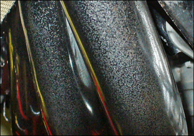

How would you prevent the headers from rusting to begin with? It's mainly on the front surface of the headers where the wind hits the pipes straight on. The engine guards are about the same position on the bike and the engine guards don't have any rust at all, so it's the heat from the exhaust....if you own a Valk, you probably know what I'm talking about. Feels like it's pitted. (Pic enlarges)

Tomorrow, then. There's a lot of salt living near to the ocean. Salt has to end up on the streets, year round.

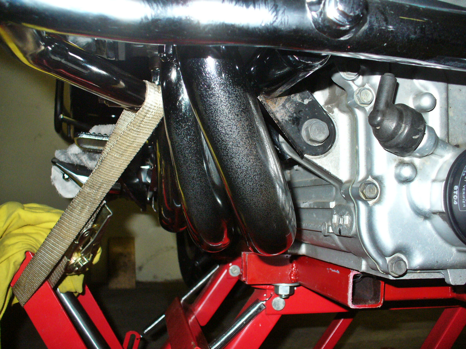

I think my headers still look like this after I clean them with a Dobie pad...
but I never looked at them under a microscope  Smiley ...

What did you use to paint your pipes behind the shield?  I tried a VHT clearcoat paint, supposedly for exhaust manifolds and headers, but it burnt...yellowed.  That silver seems to be holding up (unless you just did it), what brand?
That's a picture of my brand spanking new $220 eBay pipes  Smiley Wink cooldude Cheesy Grin right before I
put them on.
Sorry if I'm a little proud of them, but this is what I had before:

I thought that new pipes were a slight copper color behind the shield.  Perhaps that's because I've only seen "new" take-offs that probably ran for 3k mi.  Smiley  Congrats on new pipes, nice snag.
I got them probably over three years ago... that (and the condition of my other pipes  Smiley ) is what made
me think I needed to jump in and say that they'll probably only stay decent if we  get down there and
get the grunge off with some regularity... like I said, they still clean up real good... 30K or so and lots
of rain and grunge...

I want to note that the rust (below) is in it's early stages. But it seems like the chrome on the headers went from shinny to noticeable rust in a week. What makes things deceptive is that the factory chrome on the nearby engine guards and the timing cover are all the while in pristine condition. Our story begins....the only water faucet in our building's basement garage is located behind a parking stall rented out to another tenant in the building, so if his car is parked in the stall, we can't wash our vehicles. There was a year period that went by that whenever I wanted to hose down my bike, the car was in the stall. So using a water bucket to give the bike a sponge bath, I rarely reached down to wash off the headers, and I guess, that allowed the rust to sneak in. There's a moral to the story. Furthermore, I've seen photos of Valks with rusted headers in its advances stages and it don't look pretty at all. Not to mention that brand new mufflers cost $679.64, a piece.

One thing everyone needs to remember is chromed headers are subjected to heat of several hundred degrees and things like bumpers are not.  Also, a lot of Kury stuff is chromed aluminum.  There aren't layers of copper and nickel between the two.  Other manufacturers are just as bad.
Marty
redflash
Posts: 143
Southern New Hampshire
« Reply #35 on: June 28, 2011, 09:19:52 PM »
pics sometime, but my headers are completely rusted over. 75,000 miles in 5 yrs, Kury stuff is bubbling under the chrome and the chrome is flaking off. I ride, don't do a lot of cleaning and polishing. Stock valve covers look great though!
