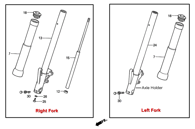

I have fork oil leaking on the left fork up through the threads of the fork bottom. Now how do you like that one! The fork bottoms twist off and there is on odd shaped o-ring in there that was broke in half. Honda does not sell the o-ring. They want me to buy the entire fork assembly! I have tried teflon tape, pipe dope, still leaks.

I thought he was talking about a seal between the chromed slider and the cast fork bottom that holds the axle.

#24 screws into the lower axle holder and there is an o-ring to seal the threads.
The picture shows one item, you are saying the lower just unscrews from the fork tube?
How would you go about unscrewing it them?

I was unawares of that too. I guess that's how they chrome the axle holders.

I think there's a hole in the slider towards the to into which you can insert a punch to hold the sliver while you take the fitting off. Or (in the case of my ZX7) you just put the slider in a vise with some rubber jaws and the bottoms come off pretty easily with a little heat.

Thank you for the suggestions. It is part #24 that is leaking from the axel holder. I am going to try Zatkoff. Next may be some permatex product. Got to get this done before INZANE. Thanks Again.
