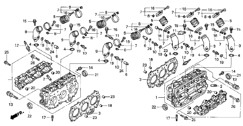

You just need to put those little chrome hold down jiggermabobs back on top of there.
It's called a STAY, AIR FEED PIPE  Part Number 17115-MZ0-000
It's number 11 in this photo:
